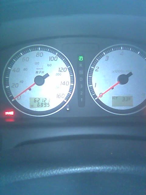

you probably want new gauges too that dont have the "P R D 2 1" on them
i have an auto and my gauges dont say PRD21 on them, the shifter base does, but if youre gonna have a manual you cant leave that there anyway, unles you plan to only use 3 and 4 gears...

Originally Posted by NmexMAX
90% of your posts suggest that you don't know you're talking about.
and 100% of your replies show that you need a swift . if you have an auto and you see P R D 2 1 somewhere on your gauges please take a picture of it. cause i dont have that anywhere in my gauge cluster. It is however on the shifter base (the plastic thing with a post sticking out, topped by a leather ****). Ie: Park Reverse Neutral Drive 2nd gear 1st gear.
im saying if you do a conversion you cant leave the auto shift patter in because otherwise you wont be able to shift...
and if he means the thing in the middle of the cluster, he wont notice because IT WONT LIGHT UP!!!
Dude ,you must have a Ghetto rigged Auto, All 5.5 Gen Autos have It, Also you can use a AT Gauge cluster on a MT just the P light will always be on!
Maybe 02's didn't have it
Who gives a flying as.s **** if it doesn't light up after the conv.
PRND321
I have it on my 02.

i have it, i used to own a chevelle and i was thinkin about the fat thing on the bottom of the gauges and wasnt really thinkin bout my car...i no . Who looks in the middle anyway? the gauges that matter are on the sides of that. the point is, if you really want to pay money to turn out 1 light, you can instead donate it to me and ill put some black construction paper in that slit.
