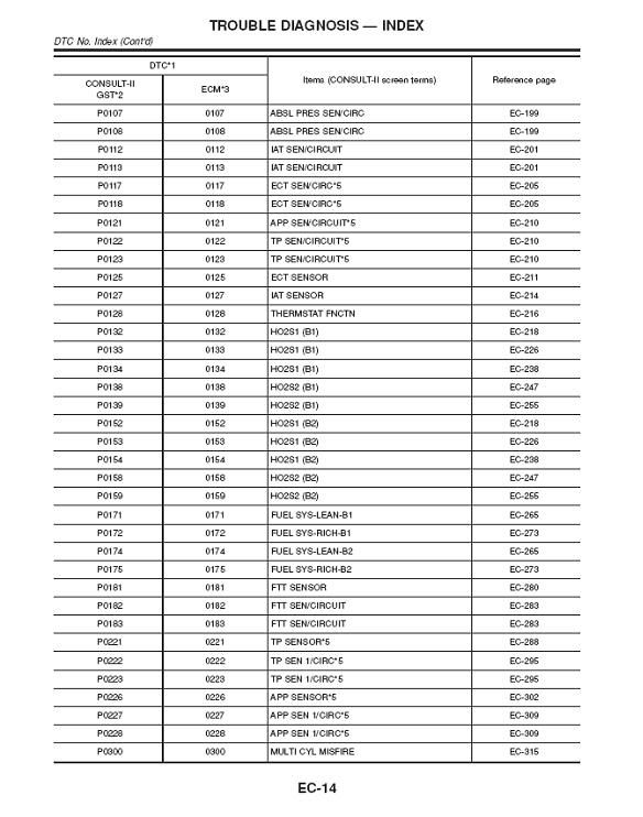

I think its means P1147, which is a code for the rear heated O2. And yes, intake leaks are listed as a possible cause, as well as:
Harness or connectors (The sensor circuit is open or shorted.)
Heated oxygen sensor 2
Fuel pressure
Injectors
FYI, the Autozone code readers have different codes from Nissan sometimes...
No P0147 found in the Nissan FSM for a 2002 Maxima:
