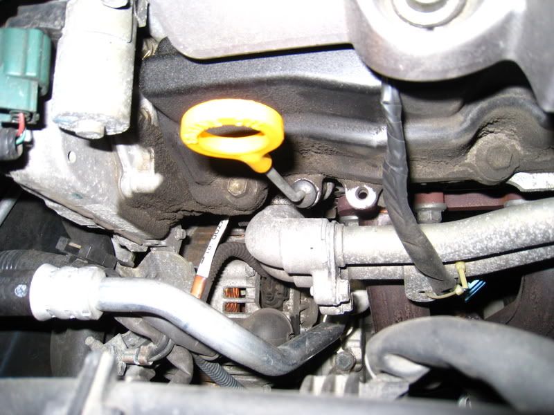

Bump because I noticed this about 2 months ago but never had a chance to do anything:
Pretty sure that is oil buildup under my front valve cover. Seems that most of you are having issues with the rear valve cover. Anyway, new valve covers will be ordered shortly from Dave B. I need to clean that engine bay up at some point I guess, lol.
I have this exact same problem, I need to do mine as well.
