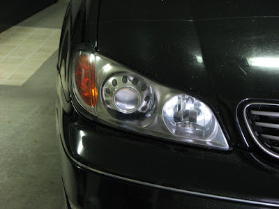

I think what Armon was trying to say was use E46 shroud seen below:
And def color mod the TSXs, then you'll get this:
Now I wish I went the TSX route. Maybe my next project.
i have color mod'd my tsx lenses, and aiming them is a pita. Since they look like they are facing down in relation to the shroud, but the light shoots straight. So in other words, it gets complicated to make them look good with a shroud around them pointing straight, and having an even beam pattern st the same time.
