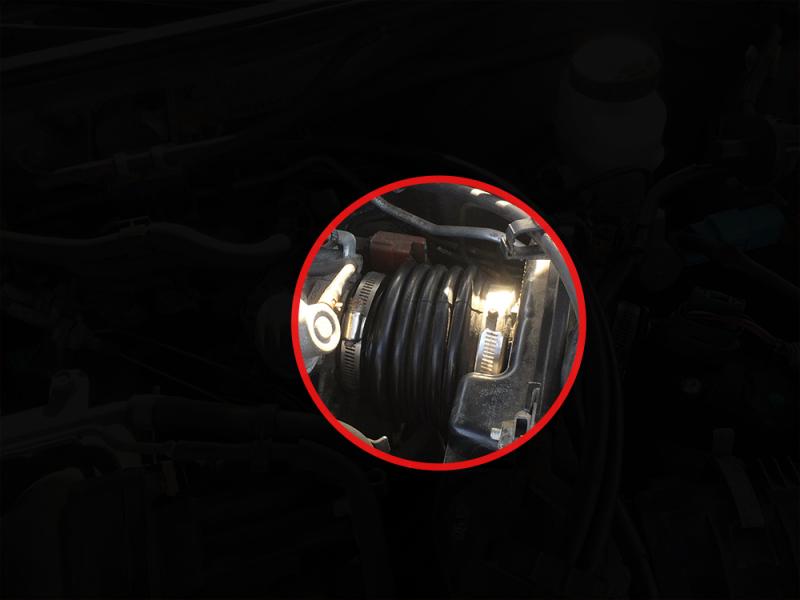

Had the same problem, changed the MAF sensor - SOLVED!, for another couple days... Since I bought the cheapest MAF I could find, I decided to buy another one. Another one came with the tube, so I decided to remove all that stuff and install a new tube as well. During this procedure I noticed that air intake hose frayed. Fixed it with electric tape, now it works fine.
For those of you who has the same problem, check this hose first ( need to remove all )
