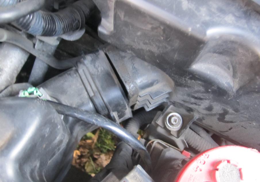

so i just replaced my entire maf sensor because my car had some serious issues. when i put the air box back, i noticed the part leading away from the throttle body wasnt really connected (pic below). i was thinking about just duct taping it so it was connected, is that okay or this a problem?

You should be able to push that all back together, Spyderpig. I doubt ductape would hurt anything, but it sure will look, well... duct taped...

yea, i would prefer not to duct tape it but i tried pushing it back together and it doesnt reach... also, i know it goes into the air filter but what exactly does it do?
2000 maxima

Its an additional duct to direct air towards the filter. No, not ram air, just a small aid. Shift some things around and it should go back.
I sort of had the same problem. Drilled a hole in both parts, and put a screw in there to act as a locking pin if you will so they wouldn't move around.

^ This. Just loosen the bolts and move the parts around until things line up. Then re-tighten.

Did it yesterday, car us burning gas but it didn't do a ecu reset so I'm doing that right now.
