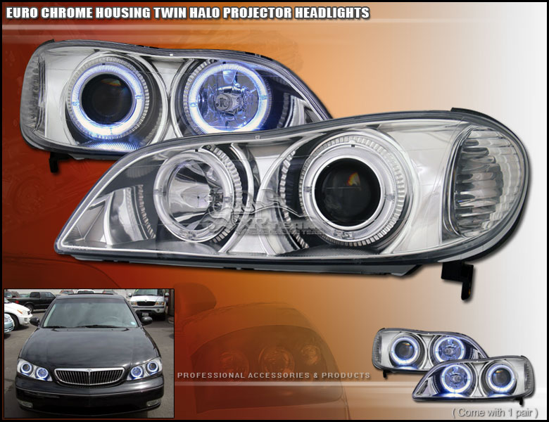

nope. i don't think anyone makes them. it's very likely you could use someone else's AEs and make em fit. like the DDE's i have i coudl probably get into your housings but they will not look 'good' up close. from 5 feet away they would look fine though...i'd say i'd experiment for you but i have no spare I35 headlight.
they do make these for your car but they look cheap and probably suck.

Those do suck lol, output and AE wise, the LED's are so weak you can't see them during the day.

one option would be replacing the LEDs with super brights and or more LEDs. i could easily do that. but again i doubt it's what you're looking for.
