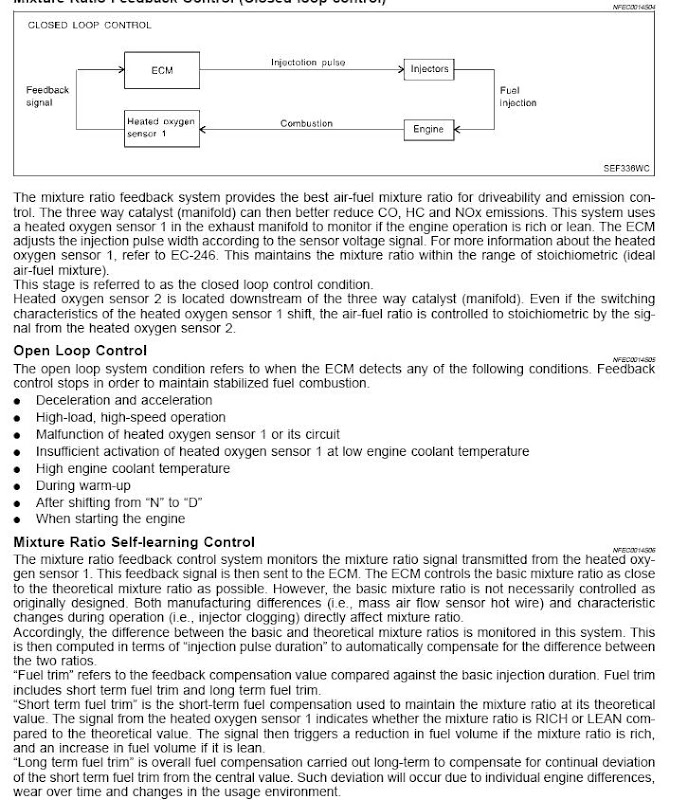

Something to do with closed loop vs open loop. Any codes? Possibly O2 sensor?

Pre-cat O2 sensor has been replaced although I'm not saying it wouldn't be bad again but no helpful codes at all ever.
