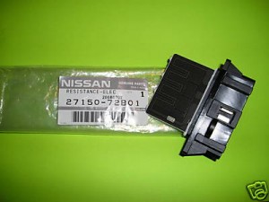

Looks something like this
The resistor looks like this.
