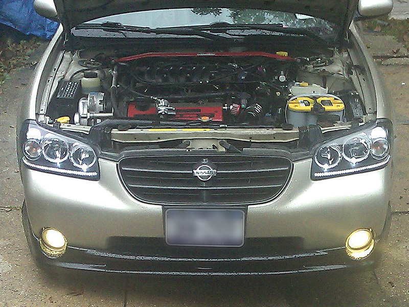

I did it the other day.
LED strip had a self-adhesive backing.
Found a good spot for it, removed the paper from the back, and just stuck it on. Spliced the wires into the corner light, and that was that.

Well, the pic is Autozone LED strips from the ricer aisle.
They're sealed waterproof strips with SMD cool white LEDs.
What I did for the guy's car in the pic (Maximus681) was we removed that 8" strip of rubber molding on the bottom of the hood, and put the LED strip on the outside of the headlight lenses right there. I wasn't sure on the reliability, so I wanted to make them easier to swap.
That being said, opening the headlight is not difficult after the first one or two times. Bake it at 250 degrees for 10-15 minutes then it just comes off. It's a very pain free process as long as u grow a pair. Don't listen to those wimps who say 200 degrees, leave the door half open, and do it for 3-5 minutes. That's how you end up breaking your headlight housing because you had to force it off. It comes off so easy once the glue has been properly melted, which takes 10+ minutes at 250 degrees.

I looked at the pictures on the Oznium website, and those strips are the same exact strips as the Autozone ones that I posted about. They could fit above the headlight lens, under the hood if that rubber strip is removed. They could probably fit under the headlight lens too.

They are the cool white. Not sure how much they cost... my friend picked them up and I just helped him install them.
Here is another... the grille ended up blocking part of them, since the headlights are aimed in a little bit. But we were able to get them to fit the hood by removing that short rubber strip.

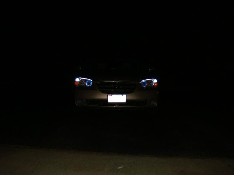

Ok, so after looking at this thread TODAY, I went out and bought the autozone version of the audi LED strip, like $20 for two strips.
It comes with test button to see how they look like and connected them to my corner lights. Took about 20 mins.
The strips are barely noticeable when the hood is closed(the strips are on the outside on top of the headlights with 3M tape) and it actually looks nice, kinda like a eyelid...looks aggressive...here is the outcome...
this is actually white, somehow came out blue....

some day time pics, got some glances today while driving around
