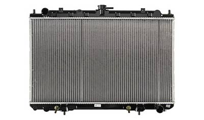

Mishimoto website says this is for the 95-99 maxima vq30 manual transmission only
this is supposed to be 03 maxima rad for automatic...
They look almost identical
