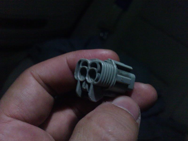

hey fellow orgers, i was wondering if anyone knows how to fix a side marker harness plug. long story short my bumper got pulled off and the wires got pulled out of the plug and the side marker plug is free.
thats what i have when i unplugged the side marker plug, can i just put in extended wires in it or what should be the way to tackle this?

Based on the photo the red wire goes in the left side of the harness and i believe the other wire is green and goes in the right. Try pressing the wires in and see what happens...

The wire colors are red with a yellow stripe and black. The red has the 12 volts and the black is ground. The red wire goes in pin 1, but it won't matter if you happen to reverse them.

take out the lock pin.
push in the wires.
re-instal lock pin.
enjoy.

how do you take out the lock pin?
