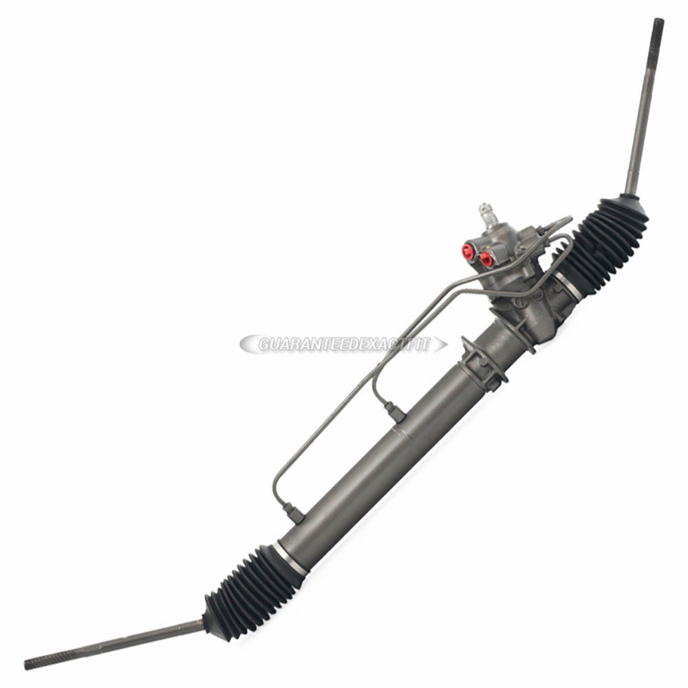

I recently noticed my steering gear rack was leaking. I tried to old stop leak stuff (of course it did not work). I just ordered a new rack and pinion. I'm also about to pull the trigger on these parts while I've got the car in the garage for the winter.
Rack and Pinion used 66k for 85 bucks.
Front Lower Ball Joint
Front Outer Tie Rod End
Front Inner Tie Rod End
Front Sway Bar End Link Kit - Passenger Side
Front Sway Bar End Link Kit - Driver Side
Coilovers =)
Ksports
Rims
19" G35 rays (my buddies G35 rims he sold me from his car)
Now is there anything else I'm missing here? I will be doing all this stuff in my garage during the winter so I have time =). Any suggestions or input on installs or comments welcome. I haven't done a rack and pinion on a Maxima yet, however I have on a few other cars, so it won't be that bad.

Forgot to get pics of the steering rack, but its in now..not as big of a pain as I thought it was....
