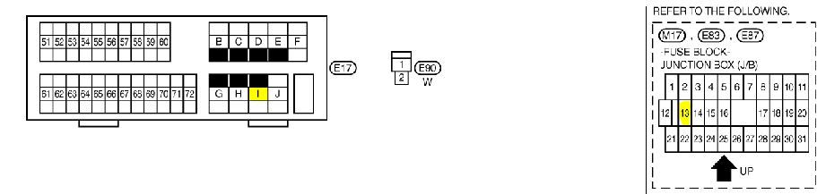

I also see that there is a fuse in the driver side junction box, well at least it is showing the fuse #13 is for the power windows ... but puzzled by that you can operate the rear windows ... so it also could be the switch itself.
Also found this thread on the window topic http://forums.maxima.org/5th-generation ... oblem.html
