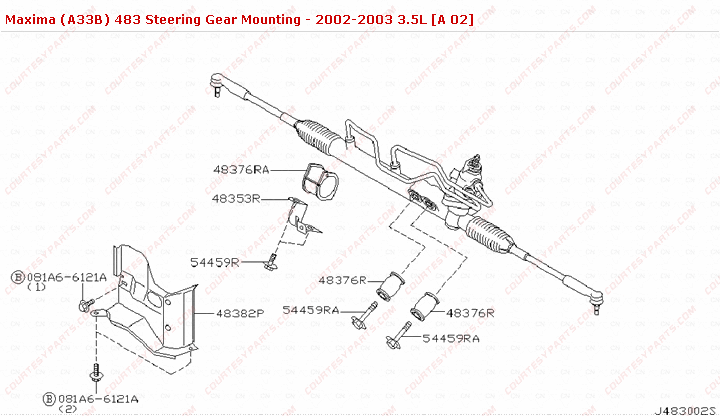

Steering rack bushings?
A search yielded nothing, and I don't see a specific reference to the steering rack bushing(insulators), but has anyone replaced them to any effect? If so, which did you replace, as there seem to be 3, 2 of which appear to be inserted and perhaps pressed, the other being a split outer bushing that mounts with a bracket. I'm guessing they're a pita to get at..but perhaps worth replacing.

I'm having trouble finding replacement steering rack and pinion bushings, as is StevieB. Local parts stores are telling me it's dealer only, and the dealer's telling me they only come with a new rack (listing at over $1,300.) What gives?
What brand subframe collars are you guys using?

Does anybody know where I can find a set of rack bushings? I had to remove the subframe to weld in new capture nuts for the engine's crossmember, and would really like to change these bushings before putting the car back together...
