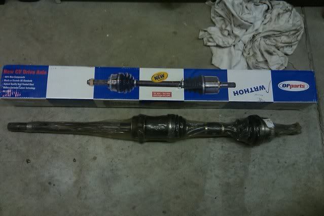

Yes, I was also one of the suckers who bought GSP axles. Paid $120 both both L and R axles. Anyhow, always had the infamous shakes after installing.
Finally, after 14k miles, I got fed up with it and purchased a OP Passenger Axle made by DSS out of China from Federated Auto Parts for $125.
I speculated what my axle problem was. Two issues:
1. There was no OEM vibration dampener on the GSP unit
2. I had this strong suspicion that GSP was boxing passenger AT axles as MT
Since I had no OEM axle to compare, I had to wait until the OP axle came to see. Let's just say, I'll let the pictures tell the rest of the story.
D@MN GSP AXLES!!!!!!!! Anyhow, the shakes are completely gone, the OP axle fit perfectly. So far no issues.
Inner axle:
Dampener:
Outer axle: (C WHAT I C?)
AT axle length compressed is 38 3/16"
MT axle length compressed is 39 3/16"
Hmm...
EDIT: For those who didn't catch it in the title, look at the pictures, read the thread, or see my car description under my avatar, this is a manual 6 speed. Just say'n...

If proof of the old GSP vs. new OP axle comparison pictures was not enough, here are the install pics I took with my phone while I was installing.
Removed from box:
Old axle coming out:
New axle going in:
I only found out about the similiarities between AT and MT axles this past Monday when I was researching, driving from NAPA to Auto Zone to Advance Auto. Not back in Sept of 2010. As for the shake, I seriously contributed it to ball joint and/or lowering springs on the brand new axles. The passenger axle fits just like it should. I saw no reason to believe it was the axle until I ended up replacing all the other stuff and realized it had to be the axle.
I installed the GSP units at 146,700 miles. My car now has 159,700. Sorry, I guess I was off by 1k miles. Oops...
Back to axles:
On Monday, I ordered a reman'd unit from Advance Auto for $59.99 + core and when I got home I looked up the company and found they do not even make manual axles for the car. So I immediately went back to them and explained the issue and cancelled the order. That was when I noticed while searching online and calling Federatred that NAPA online info showed the actual length of the axles. There is exactly 1" difference between the two.
This OP Axle is a MANUAL axle for a 5.5 Gen Nissan Maxima with a 6 speed MANUAL...

The point is you recommended GSP knowing they had bad vibration (in your case) you did notice the vibration right away right? I don't know how you wouldnt especially when you drive as many miles as you do. No disrespect sir I actually have had zero problems with this axle but do everyone a favor and don't recommend products to others that you are not satisfied with yourself. Maybe try to be sure the OP's are good before you comment on the quality.
Curious. Do you have a manual or auto?
Back to recommendations. You seriously think I'm the first person to recommend a product on the internet on a open public forum with good intentions, then find out the product is a POS?
This is the whole reason why I made a new thread to correct my thoughts. Yea, I assume it would have been proper forum etiquette to point back to my previous posts on the GSP, but I didn't know I was going to be critiqued like this.
Also, please note. I have not and will not recommend the OP Axles to anyone. Take the information I provided as you will and make your own decision based on your own research.
My whole goal was to NOT spend $500 for a OEM axle. If this axle works out for me, I did it. I am currently only out approx. $250 and that was due to a mistake on my part for buying the GSP units under the impression that because they were listed as NEW and my buddy who is a master mechanic (not that it matters now) recommended them from past experience, I felt confident in my decision.
As I stated, we learn from our mistakes and I consider myself quite confident in all my posts at the time I am posting them. I will and do acknowledge when I make mistakes. No shame here. If I am proven wrong either by another person or even by myself, lessen learned.
