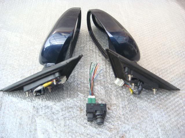

I just got my V35 auto folding mirrors in the mail, so I'm going to be doing puddle lights and signals in them. I can post them here as they're pretty much the same housing and concept.

I want pics of these uber rare things did they come with the harness and switch?

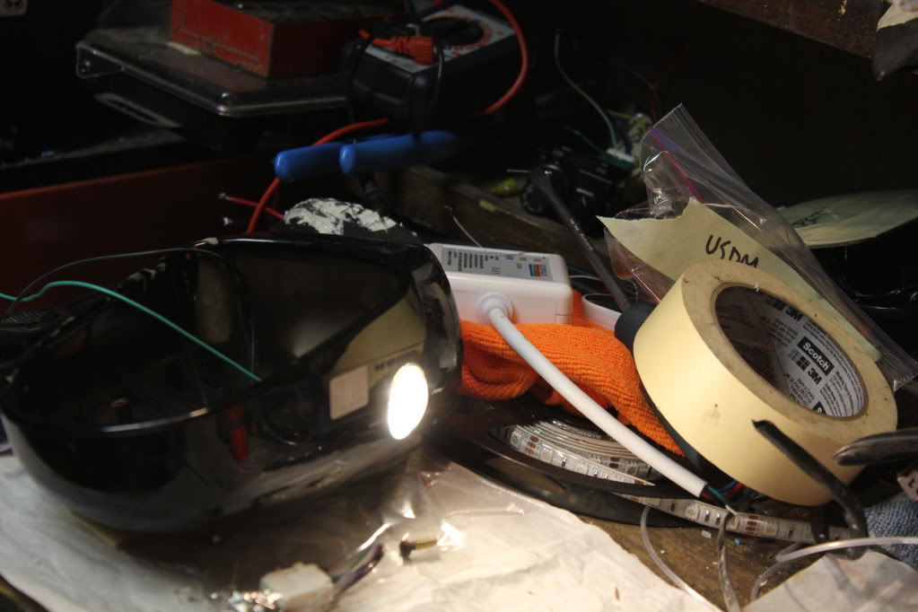

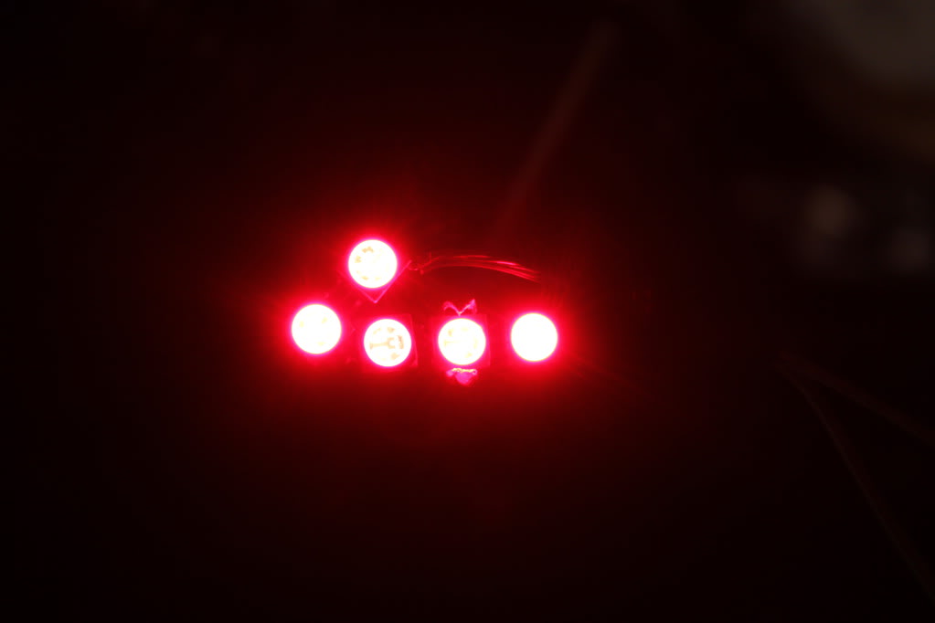

Switch and harness yes but no relays or instructions. Totally different wiring. Going to be tricky to figure it out and have it work how I want but Ima start messing around tonight and pull them apart.
The Mirror side is easy to figure out, it's the switch that's gonna be a little tougher but that should mainly be process of elimination based off the USDM switch terminals.

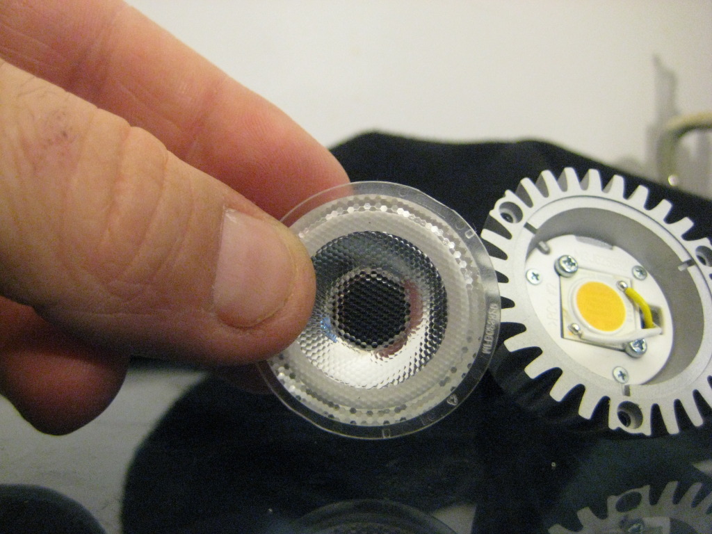

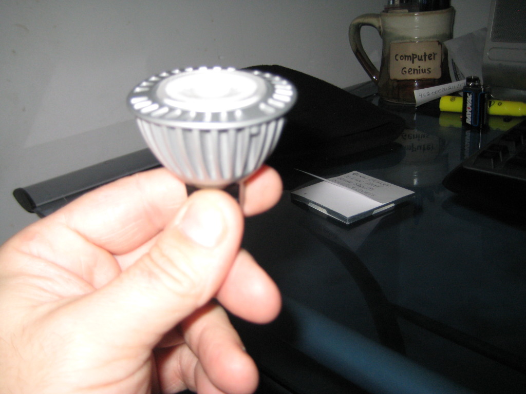

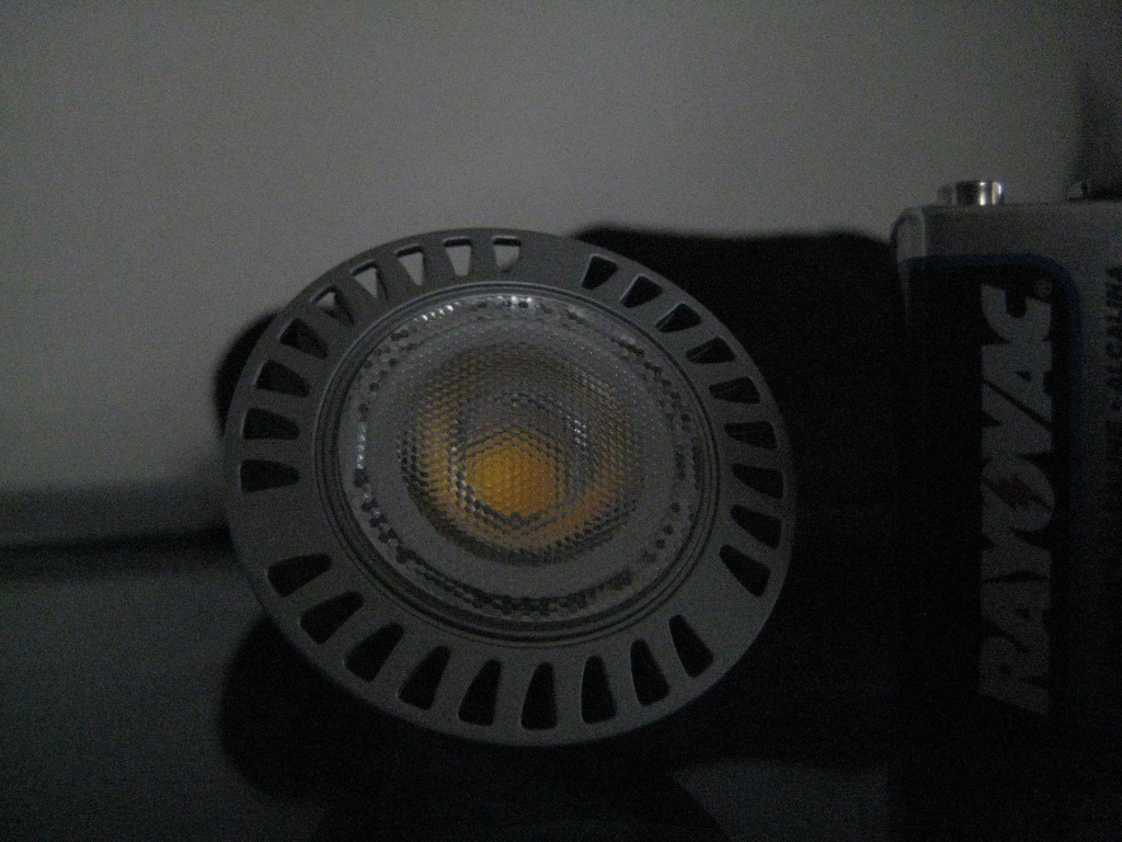

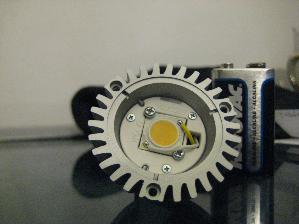

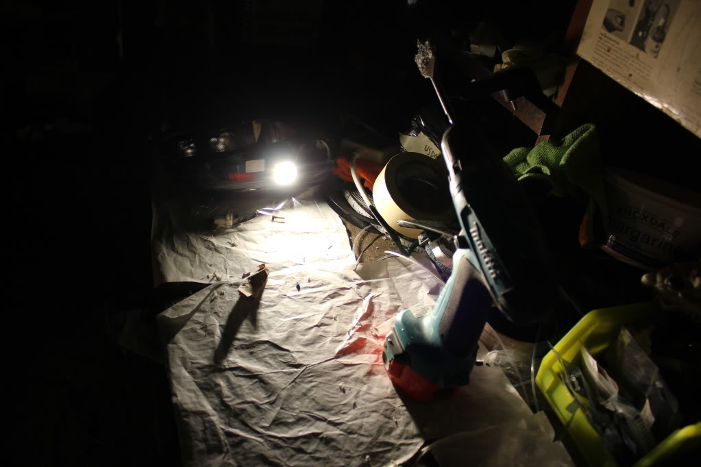

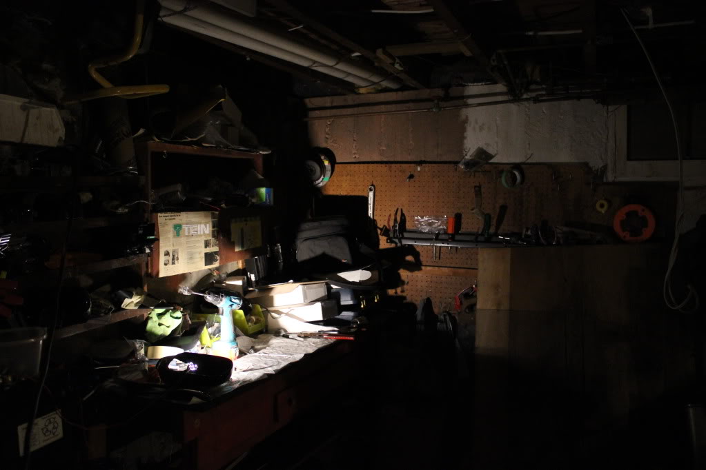

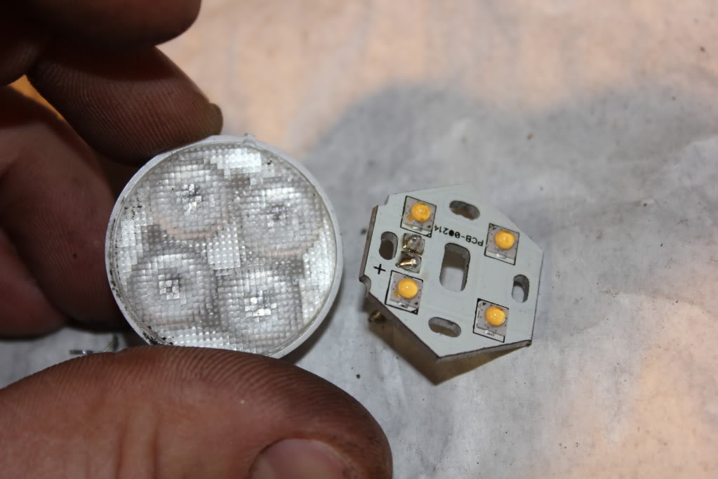

Puddle light

Niiiiice dude how many did you get wanna send me a couple?

Ill hit walmart clearence section up on wensday and pick you up a couple.at 6ft they cover my whole 15 wall with blinding light you can not look at it and they were less then $5 each

Yeah I'm down man but will they hook up to DC?
Either way grab them even if they don't work I'm down to try em. I'm starting tonight so I'll pull out the internals from the old mirrors and the JDM mirrors and start figuring out what to do for signals. I have some CREE Amber SMD's and those Strips from this thread still, plus a whack of assorted Amber SMDS....

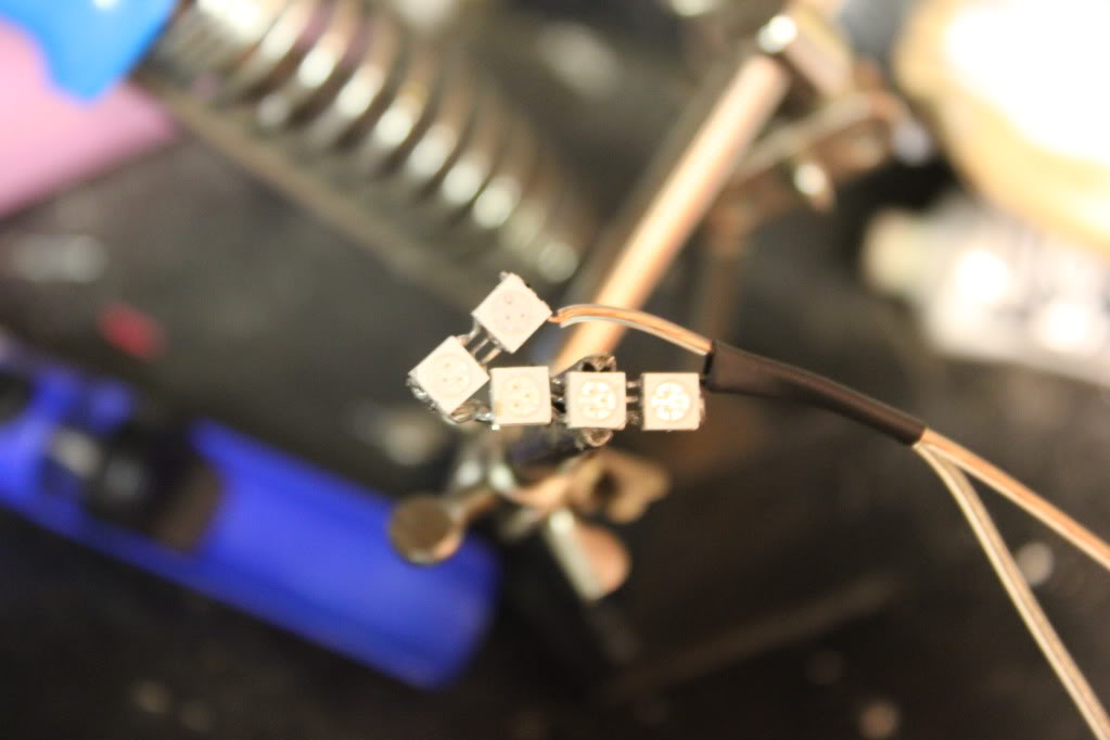

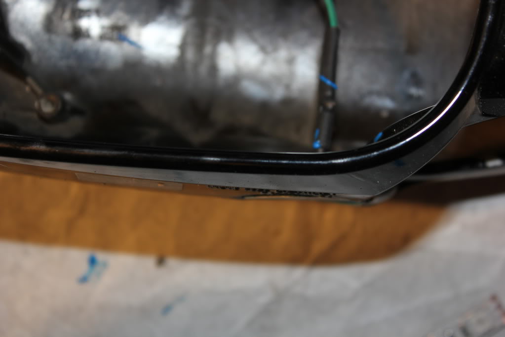

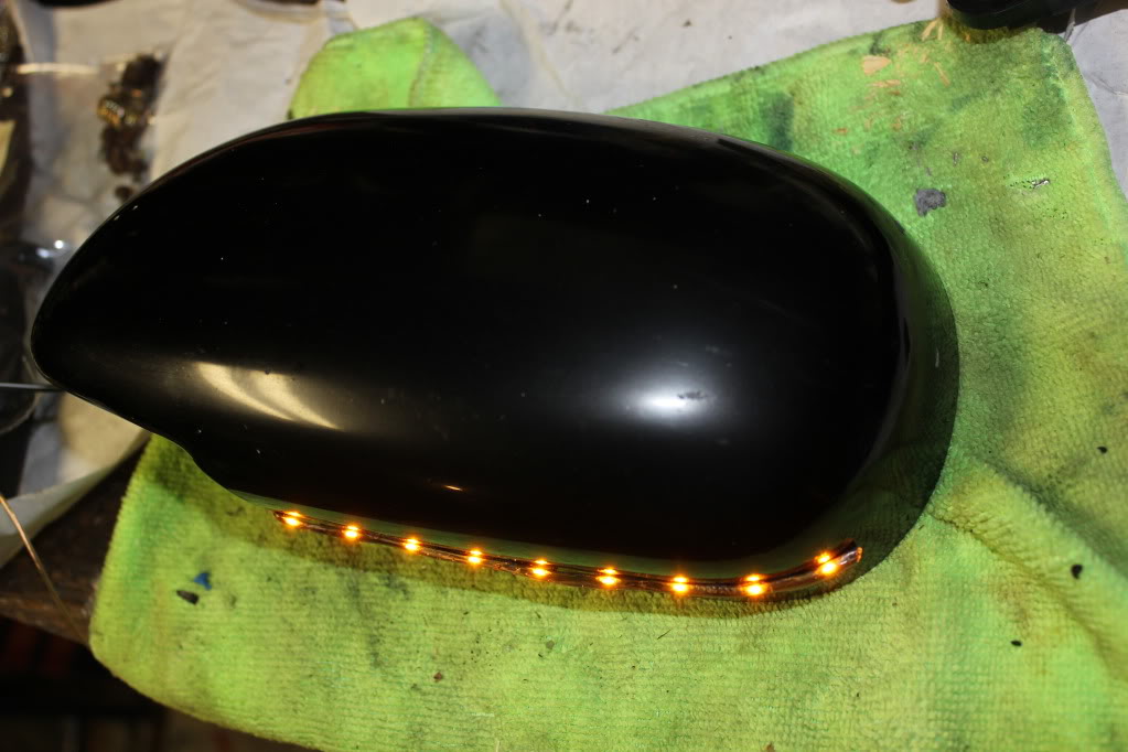

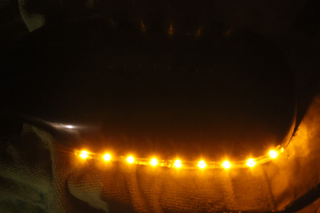

Okie so the strips don't work for me personally. I think it's a great option for many and they're pretty hidden overall, but I'm picky and don't like it. A couple snaps of them during testing:

Yup 12v ac/dc 4.4w 640ma 6000k operation and have a built in driver circuit .

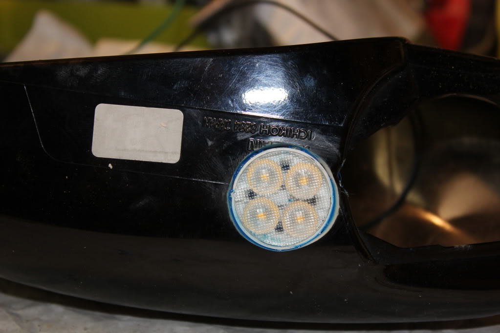

OT, but have to share.
Warning, Picture Whoring function enabled. Large Hi Res Whoring going down momentarily.

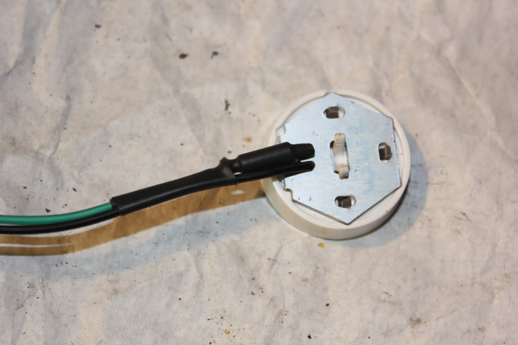

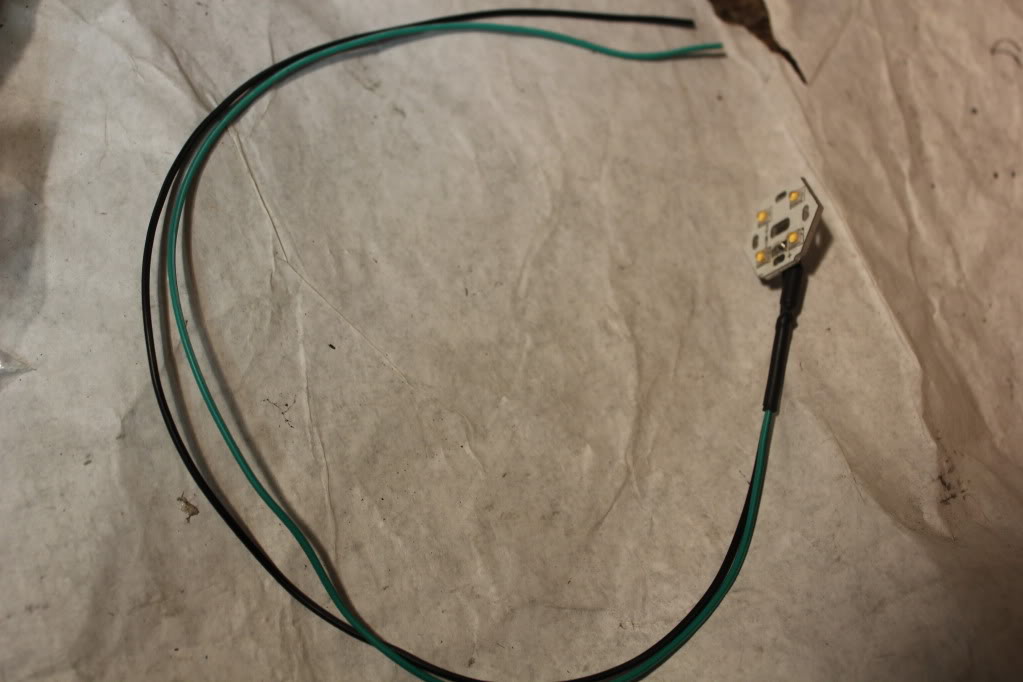

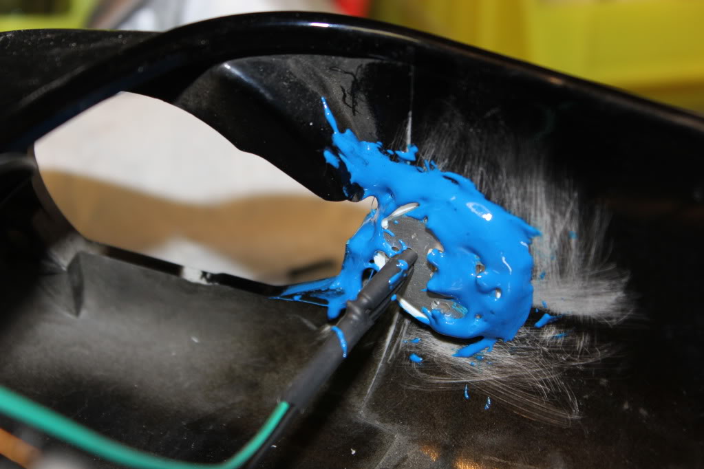

My New Folding Mirror Puddle Lights, thanks to Cjandura for the idea of using Household LED's designed for track lighting, etc:
Resistor'd and wired, 27 Ohms to dim this bad boy down some!!!

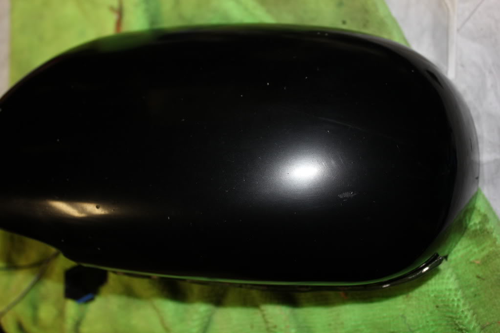

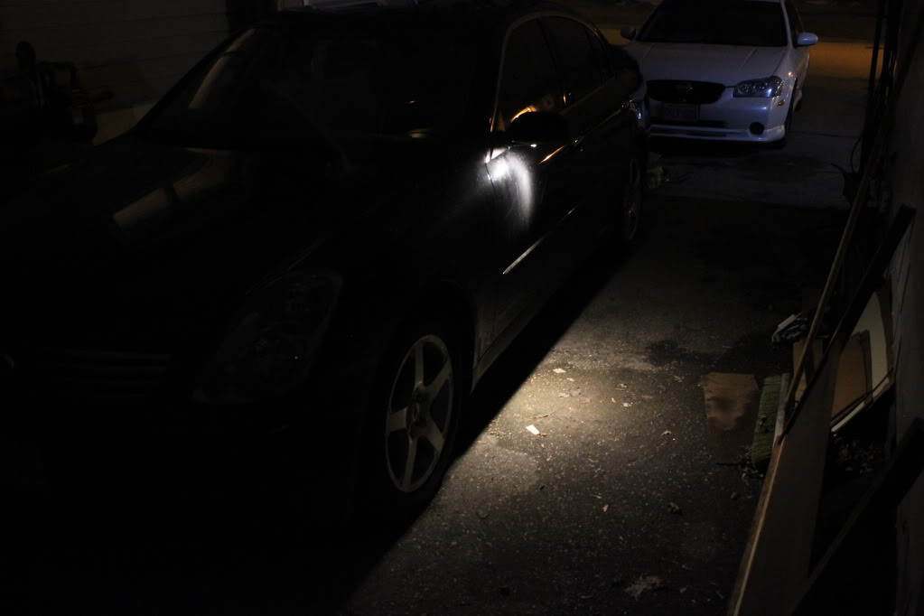

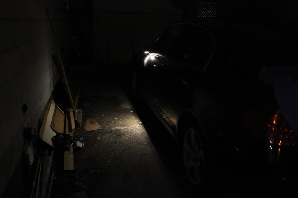

Now, installed:

Epoxy:
And finally, the output:
WAIT for it.........
That's dimmed down to about 2/3 of standard output or maybe less. It's effing awesome.
That is all for now I'll update this when I test signal integration, which I'm going to attempt.

puddle light on, folded in
puddle light on, folded out
Custom made signal LED strip for under the mirror:
^The picture I took of this kept failing upload. But I didn't use a signal, the dark tint on the mirror made the LED's look super dim, and because they're 5050 LED's, you could see the 3 chip lights and it looked odd.
I didn't have enough small SMD's on hand so I just ditched the signal idea. Less is more.

So you ended up using LED track lights for the finished product? I assume that's something I could pick up at like WalMart, Home Depot, or Lowes?
