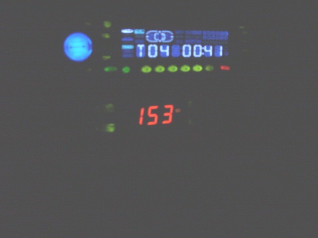

Old Dec 23, 2001 | 03:22 PM
Greg's2kGLE's Avatar
Joined: Mar 2001
Posts: 3,373
Originally posted by Newman96SE
What kind of instrument is that?
Old Dec 23, 2001 | 03:25 PM
maxse01's Avatar
Joined: Mar 2001
Posts: 621
153 too, no nos. Only intake and y-pipe.
thas not 153 on the speedo.. thats 153 with an accurate instrument.. the speedo is way off..
Greg thats the Rev Speed Meter from apexi http://www.apexi-usa.com
Joined: Mar 2001
Posts: 3,373
What do you think the speedo would read at a true 153mph?

Don't worry, he's going to ignore it by trying to cloud the issue with nonsensical BS. He's to busy inferring things that weren't actually put in posts to respond to the facts with relevant facts.
I've got formulas to show it. Someone was kind enough to post a picture of a Max with only a Y-pipe and Intake going 153. The 02 has power power than a y-pipe'd/intake'd 01 or 00 Max, but that doesn't count either. The only thing that counts is the f-body and his gut feel on everything.
Stereodude
Stereodude
Do you know how large of a factor wind speed is? I guarantee I could hit 155 in my 2000 5 speed with a 20-30 mile an hour tailwind. Does that give me a top speed of 155.... No. I'm not knocking what thomas did, but incline and wind speed have a lot more to do with people hitting 150 in their 5th gens and 153 with bolt ons in their fourth gens.
I'm sorry to say this but for a good comparison of top speed we'll have to wait for the Mags to test.
Gimme a 20 degree incline and a 30 mile an hour tail wind and I'll show you a 2k 5th gen hitting 160.
