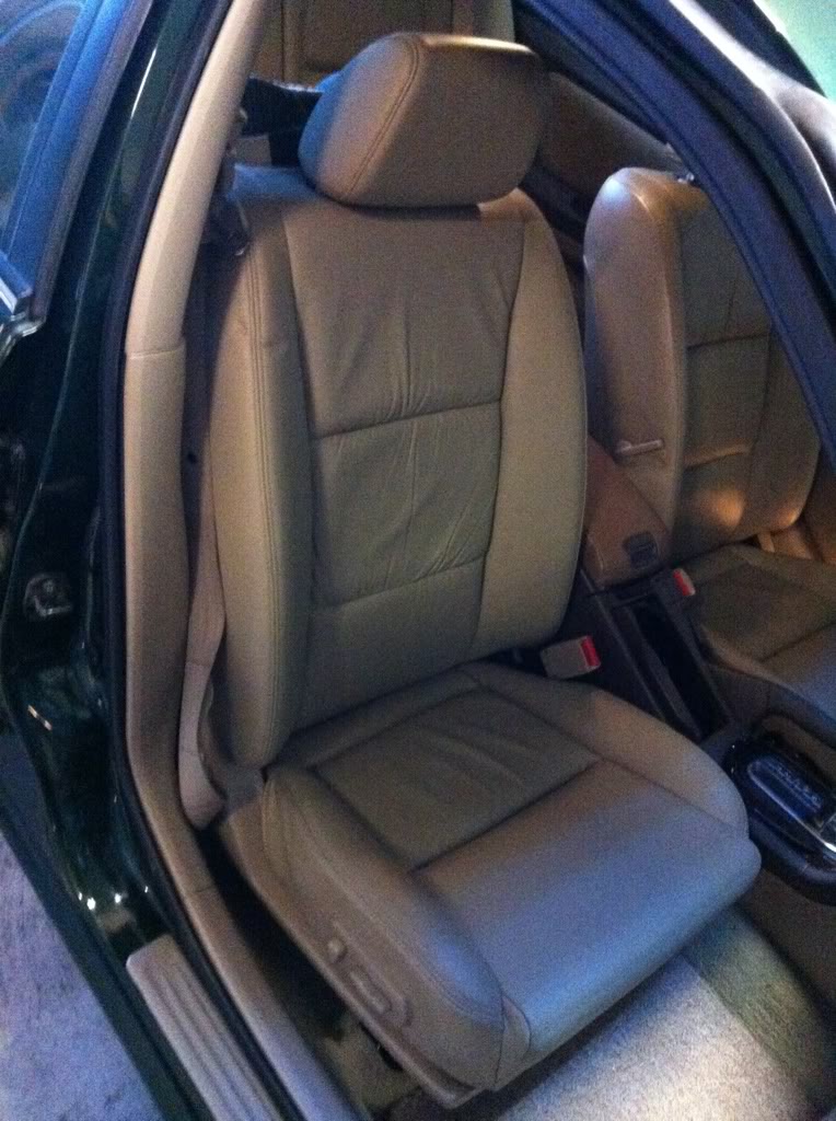

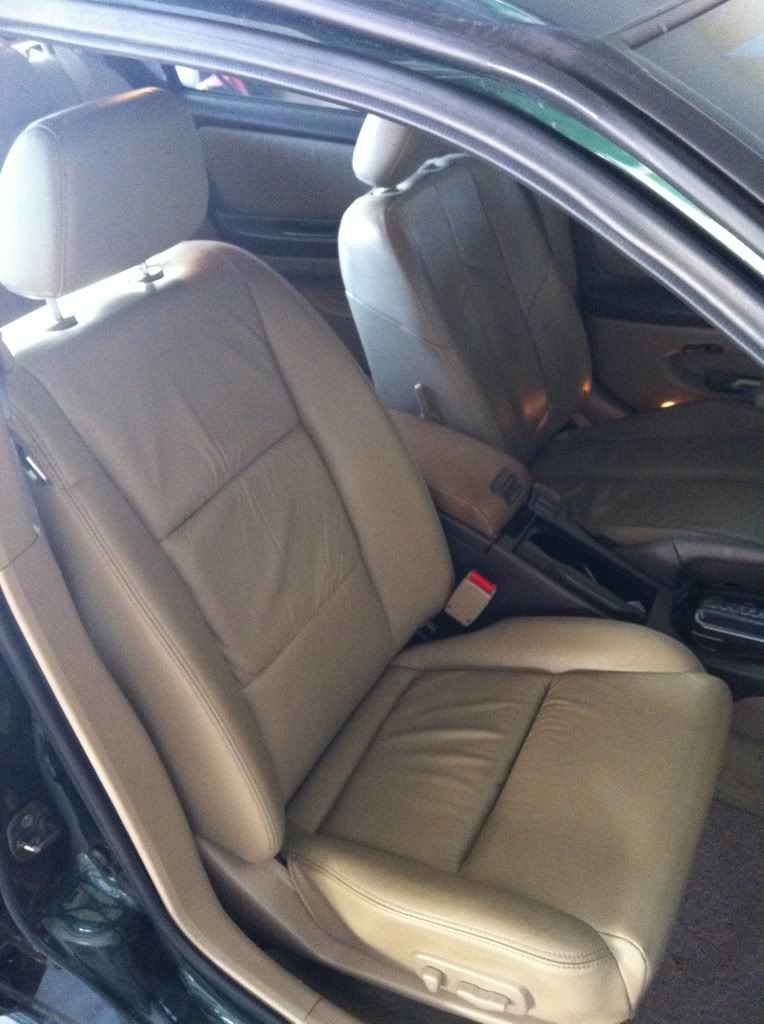

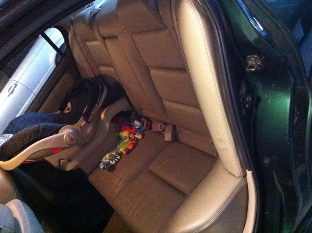

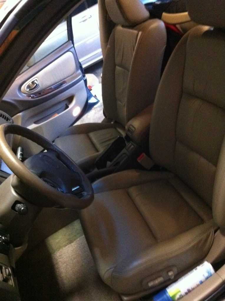

Started with a conversation of my crappy 5th gen seats to 5.5 gen!
5th or 5.5... choice is obvious!

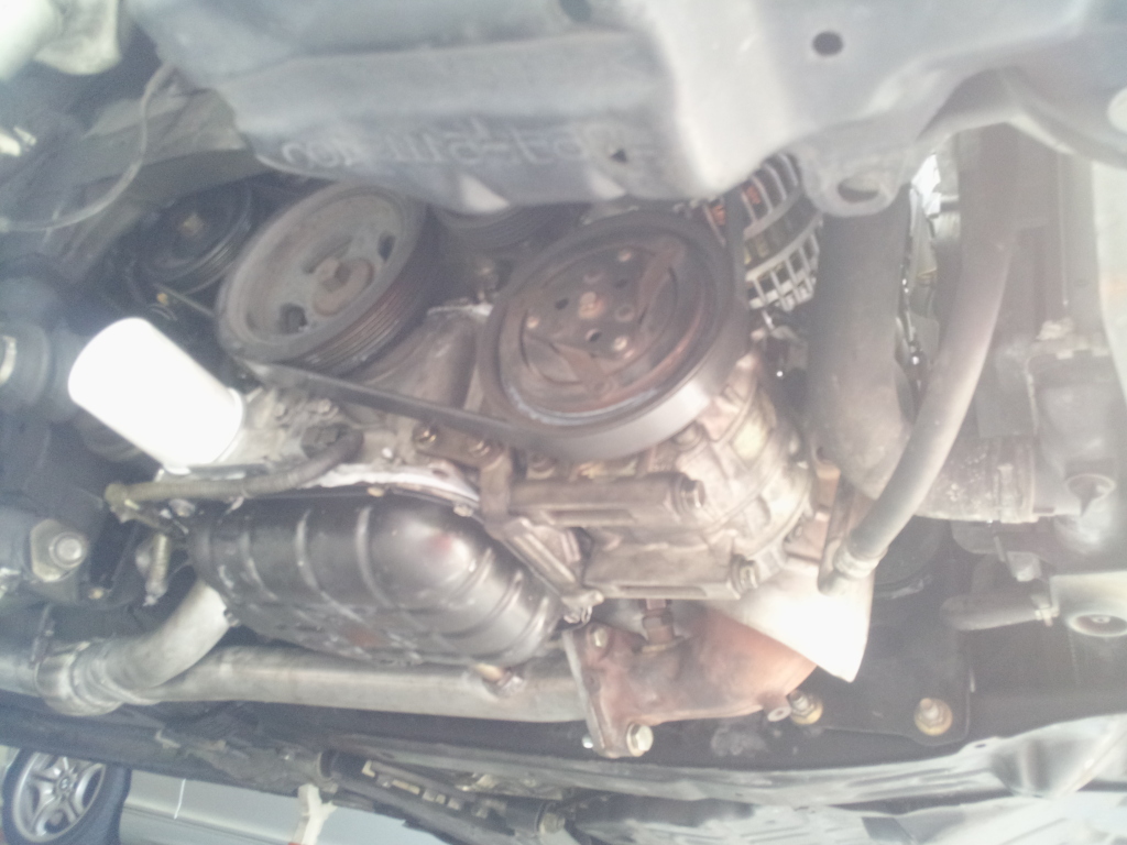

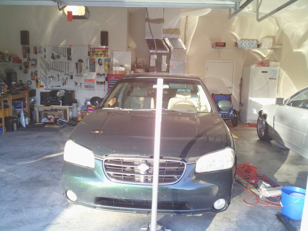

And then I had to get to my upper oil pan... did that right as we hit 200K... now at 218K and purring away without issues. Just have slight oil burning now, about half quart over 3500-4000 miles.. yeah I extended the OCI by a 1000.
All set for the upper oil pan

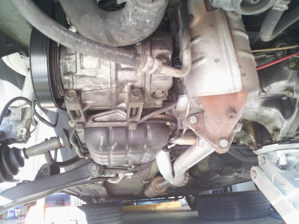

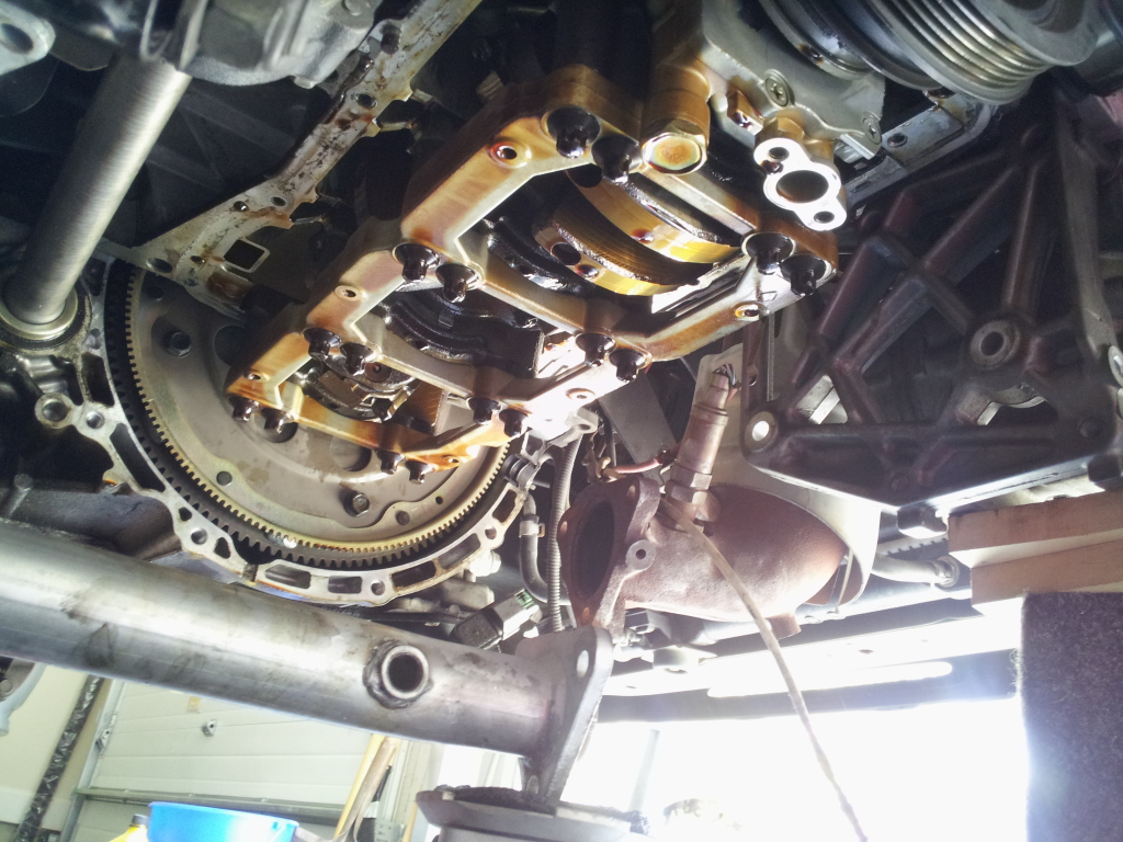

Oil pan dropped.. great to see no metal at all!

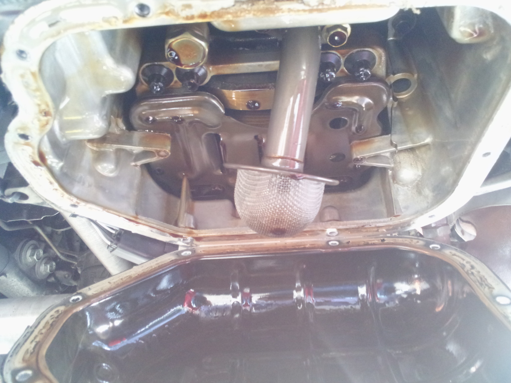

Upper oil pan dropped.. not bad looking for 200K

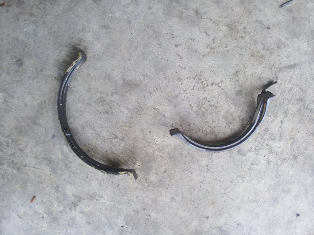

$15 pieces that dealer wanted over $1K to replace!

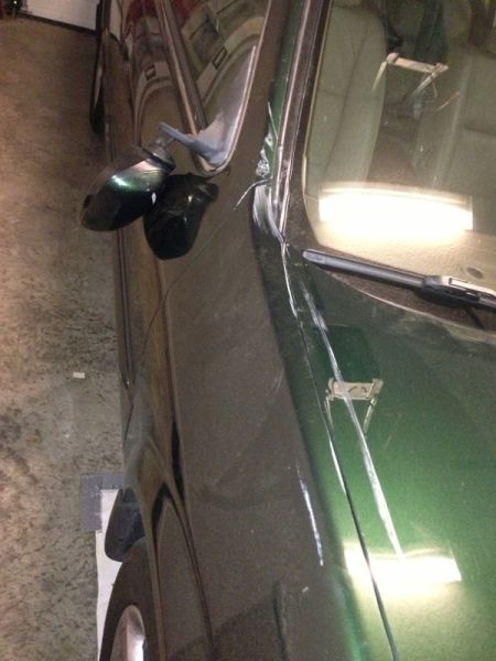

And most recently, wife hit a mailbox!.. of course had to try my hand at minor scratch fixing.

Still a little haze

Will any 5.5 gen leather seat fit in the 5th gens? My driver seat is in horrible condition, AND I've taken really good care of it. The car is almost 15 years old though.
Old Feb 9, 2014 | 06:40 PM
kukx30de's Avatar
Joined: Sep 2006
Posts: 744
Yes, that is what I have in mine. I had the 5th gen power leather seats and I put in 5.5 gen power leather seats. Plug n play

Question, where did you have your car supported with the jacks? I see the one in the front you have but can't tell where it's supported. Great write up, I'll be tackling this also. I had the front and rear valve covers done but still have a very little leak and from inspection it looks like it's either the rms or upper oil pan. I paid someone to do the valve covers but I wish I had tackled it myself, just didn't have the time. Now, I have another vehicle that I can use while I work on the Max, so I'll take my time. Hopefully it's just the upper oil pan.
Old Feb 14, 2014 | 12:43 PM
kukx30de's Avatar
Joined: Sep 2006
Posts: 744
The standard jacking points behind the front wheel under the front doors/fenders.
