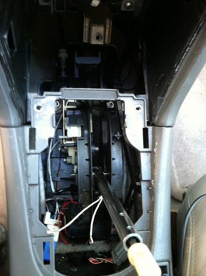

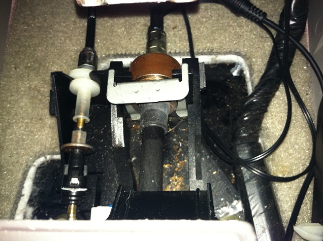

Here's a quick video I took. The little white plastic piece that should move out of the way to allow the shifter rod to move down to get out of park does not move when I engage the brake.
http://www.youtube.com/watch?v=PSppxFt5FtU
And here are some pics, if anybody could label them (solenoid, etc...) that would be extremely helpful since I know very little about the shifting assembly.

Guys I figured it out. It was just the relay. Replace that little blue plug before you start replacing brake switches and shift lock solenoids. Easy fix right under my nose the whole time.

What little blue plug. I have the same problem as I replaced the brake switch. Where is that blue button?
It is in a picture in one of the earlier posts. About 4 or 5 posts earlier than yours.
