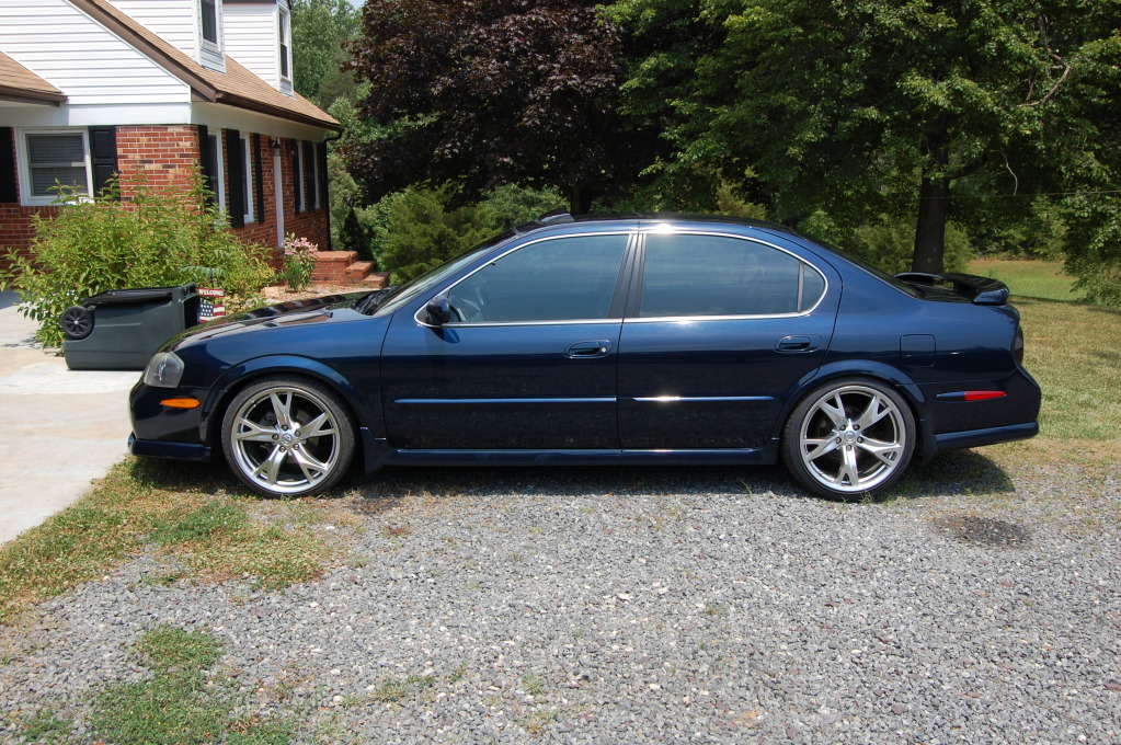

Got the coilovers and wheels on this weekend.............

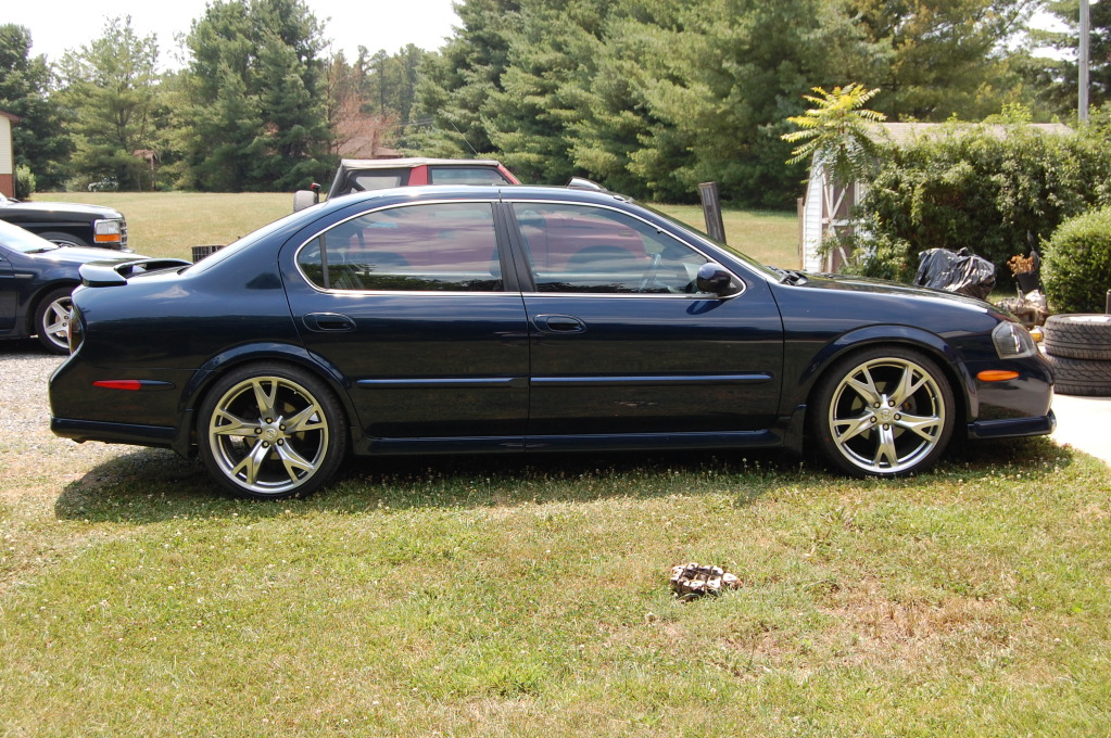

Okay, here is what everyone wants to see First of all this past weekend was over 100* everyday, so before you get started please make sure your mountains are blue

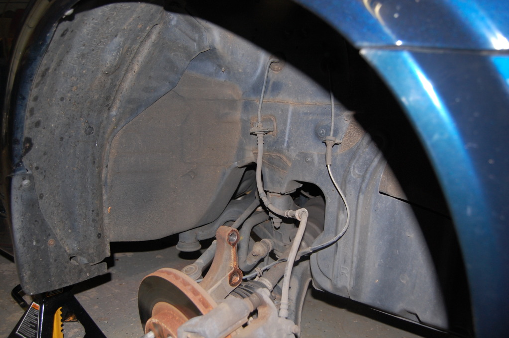

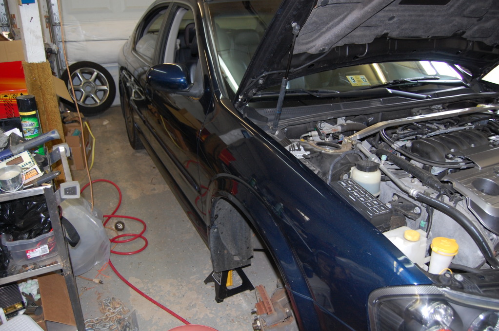

I did not take pics of every step but if you have any questions please ask. I did the front first. Front stock stuff removed.

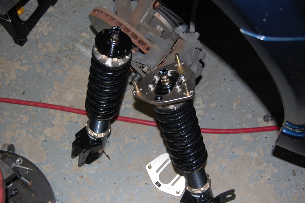

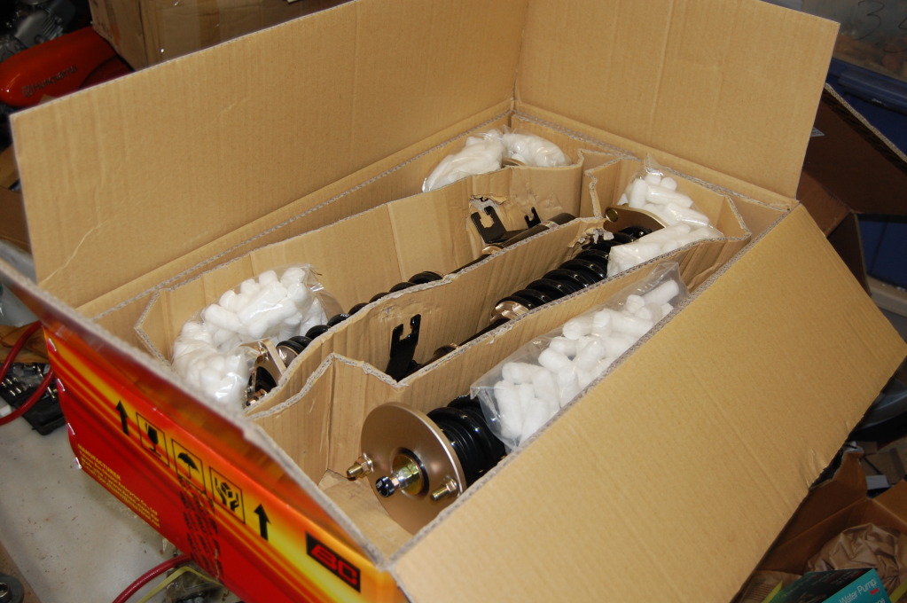

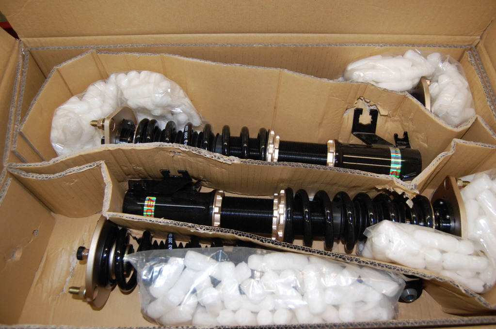

I went with BC coilovers. I got them from the guy here that does the group deal on them.

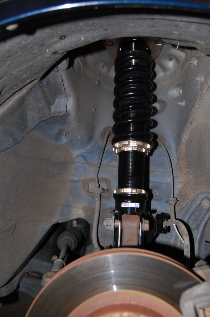

I thought BC Racing had figured out the problem that they were putting the wrong top hats on the strut assemblies. i.e. left top had was mounted on right strut/coil assembly....anyway, my set came backwards so I had to swap them around before I put the coilovers on in the front.
installed

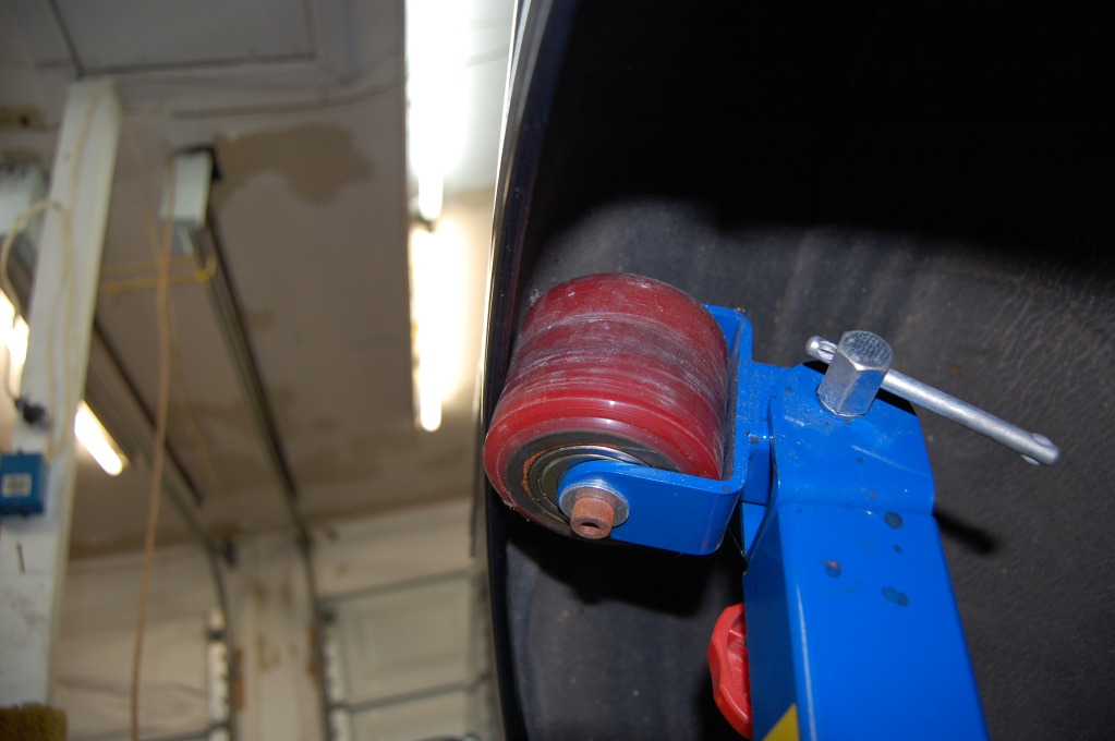

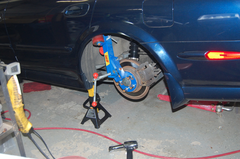

Then I started working on the rear. From talking to other people here (mainly Prince Drew) I knew I would have to roll/modify the rear fenders to make these wheels fit. So I got my fender roller out and went to work.
Tool being set up
There was also some work that I did with the hand grinder but I did not take any pictures of that. I still need to grind some more because I am still rubbing in the rear over big bumps.
Here is the fender rolled.
