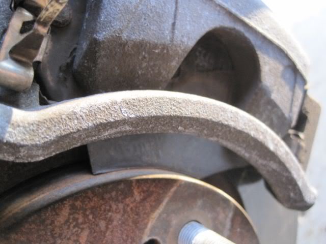

I had the dust shield issue -- but also check this -- I had this one too:
There are those little shims glued to the back of the brake pad -- presumably to stop squealing or something. I had one work itself loose and it was grinding against the rotor over time, and when I would make a right turn, I'd get "scree scree scree scree"

Just to update this, problem solved. It was the plate/shield on the back of the brake pad. Unfortunately I ended up taking it to a SECOND place (dealership this time) since I couldn't really see anything that looked like it was rubbing. Cost me $150 the first time, then when it came back a week later, dealership fixed it for free.
Anybody have a labelled diagram or pic of the area in case the problem pops up again?

Yes I do -- Looky here!
Here is a picture of the shim while attached to the caliper. As you can see, it slid down and is just barely touching the rotor. When I would take a left turn at speed (curvy road, exit ramp) the wheel would tilt that 1/100th of a millimeter which is all it needed to make a very subtle noise.

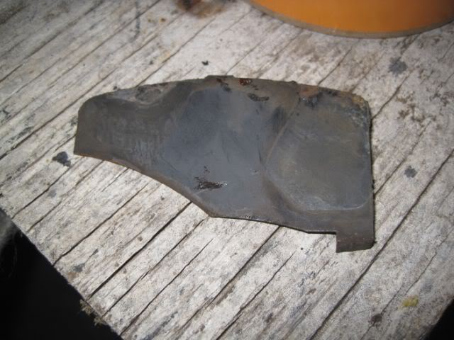

Here is the shim removed from the car. I wonder how long it was grinding away...

Remove the caliper as if you're going to replace the pads. The shim should fall out right away onto the ground.
Pick up the shim with your index finger and thumb. In a smooth motion, fling the shim onto the neighbor's roof.
