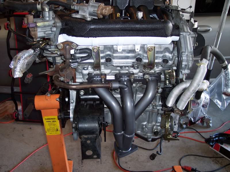

Primary....but I think I might have found the problem
Bought some Cattman headers from this guy on here and he said that the headers were off a fourth gen but they would fix the 5th gen. This are the headers that are mounted the car as of now...bank 1...photo hacked from mtrai760
Now the primary o2 sensor for bank 1 is plugged into this port causing the light to come on. We could take the sensor out of that port but there is no other hole for the sensor to go into.......and suggestions.
http://i47.photobucket.com/albums/f1...x/100_0991.jpg
F.Y.I this isn't my car it belongs to my brother I have a 99SE

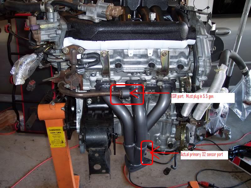

I also have the 4th gen headers on my 5.5 gen.
Not sure if I'm understanding correctly, but ... You need to plug that top port because it's for the EGR. I used a bolt, cant remember the size and welded it in there. The 5.5 gen has internal EGR, whereas the 4th gen has external, that's the reason for that port. Easy modification.
The actual O2 sensor port is on the bottom right, seen in this modified pic.

man thank you so much this will solve my problem hopefully...but did you extend the length of the o2 in bank 1 if so how

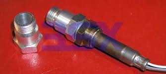

So rerouting them should make both primaries fit into the correct port? I ask because I wouldn't want to cut my O2 sensor wires and have them soldered together. Also, as far as O2 sims go where would we get them from
and...
has anyone had any luck with these:
