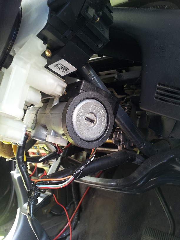

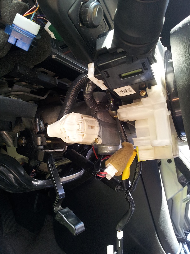

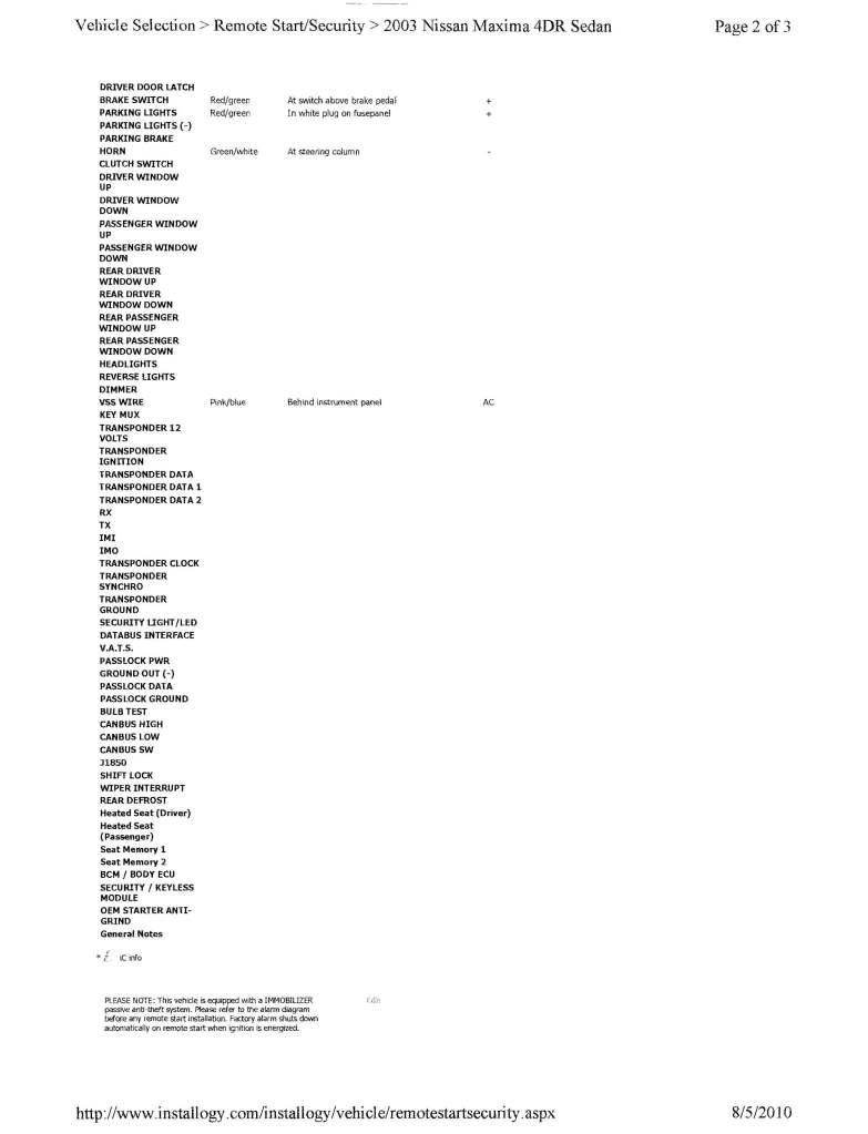

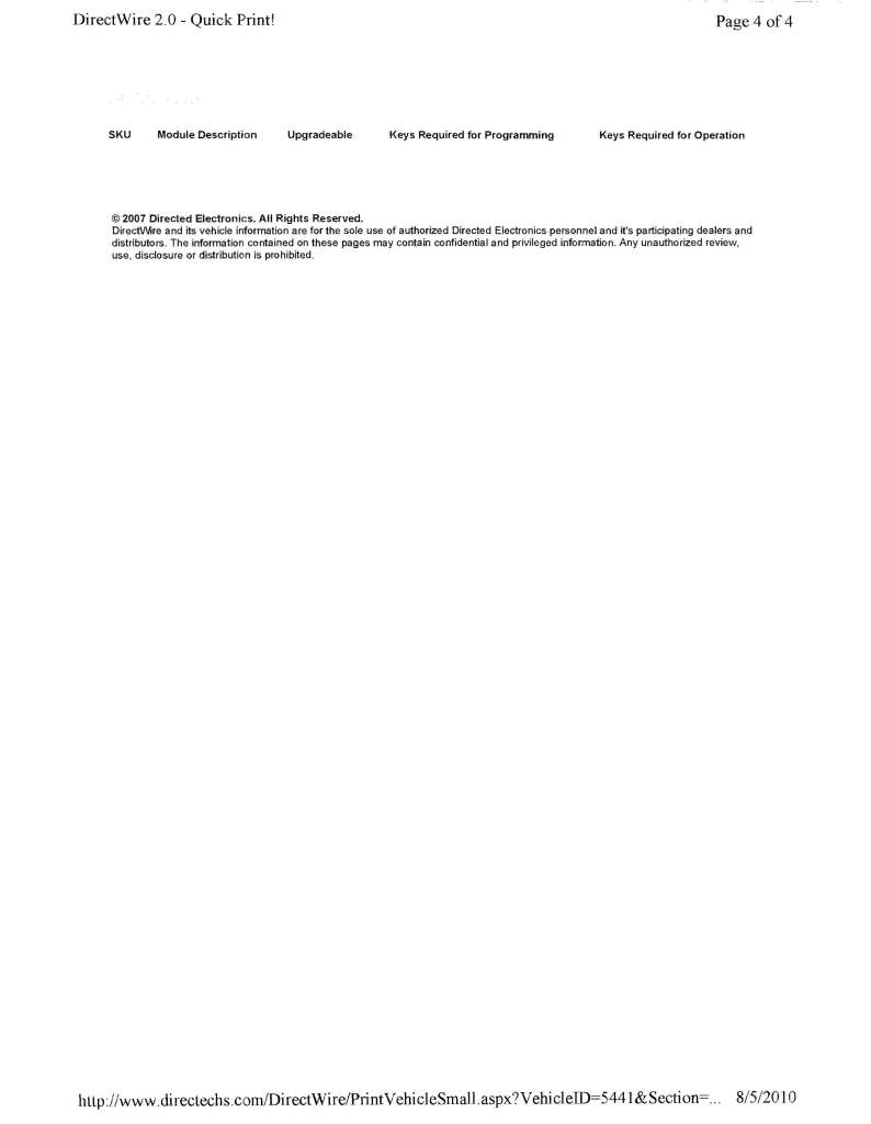

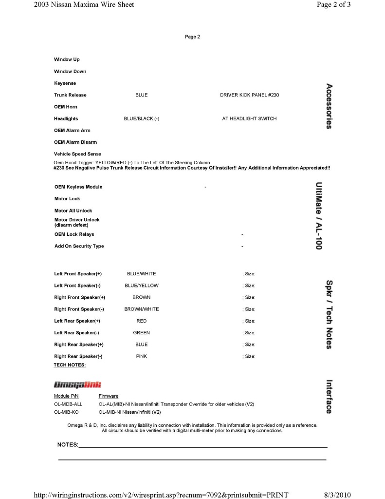

Hello all,
sorry for the noobish question, but i'm trying to install my clifford alarm / remote start on my '02 maxima automatic and i'm having a bit of trouble to start off. i've seearched around the forums but can't find an answer so i decided to see if someone here can help me. i'm trying to find the ignition switch harness but the picture from bulldog security where it shows the location seems to be from a different model. i've uploaded a few shots of of the steering wheel column area to see if someone can point out which ones i'm looking for. appreciation in advance!!
p.s. - edit- resized pics

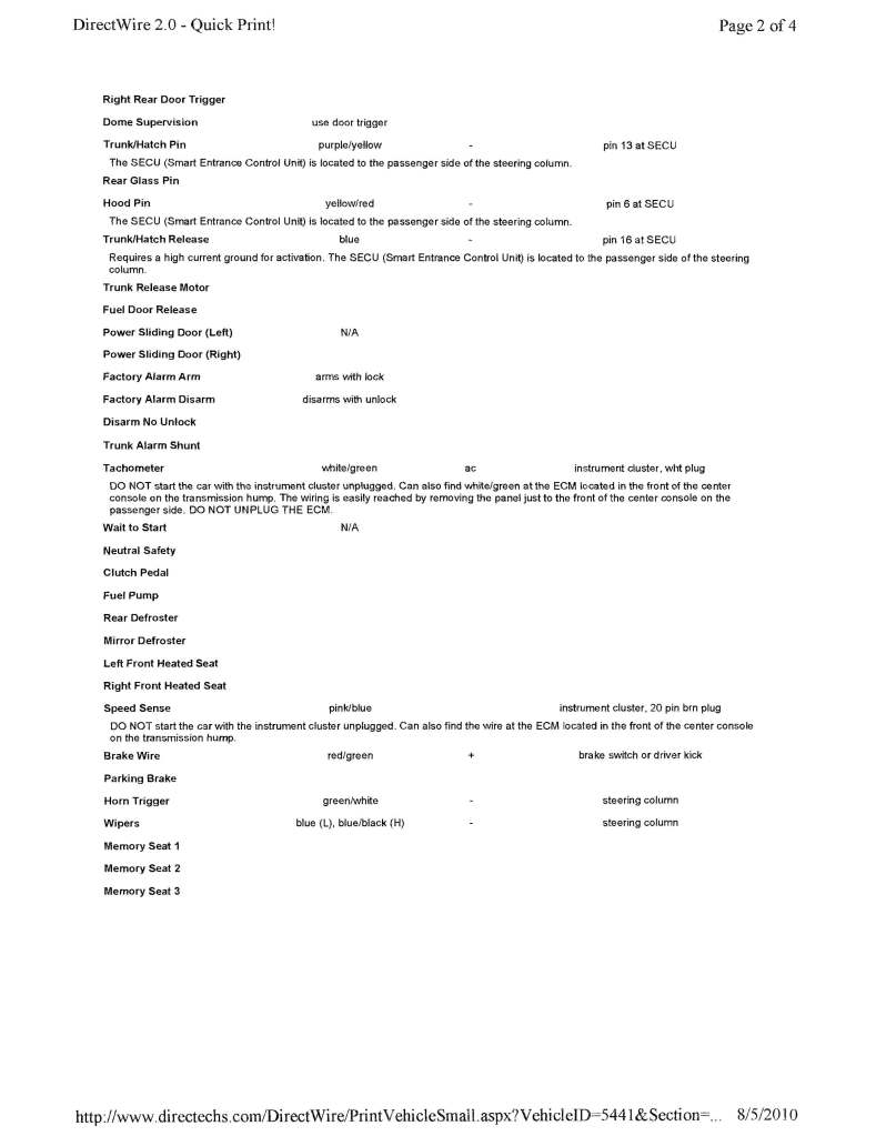

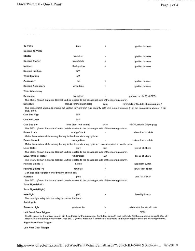

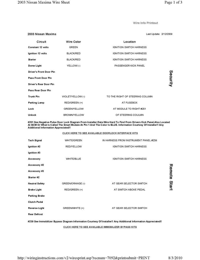

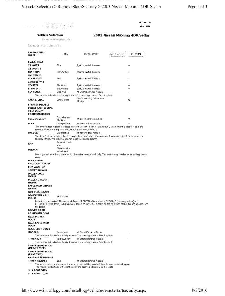

Thanks very much!
Additional question: Is the h2 harness strictly for additional modules or it can it be left off completely?
