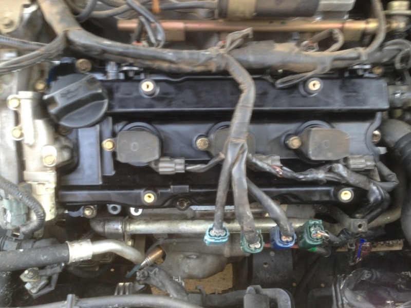

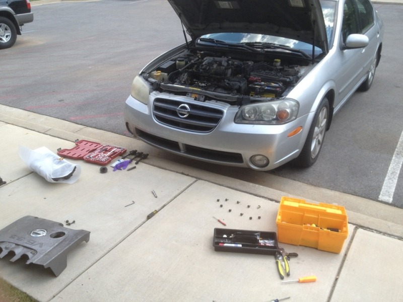

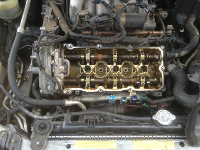

when i bought my car 4 years ago, i vowed to learn how to do my own work for the first time in my life. this place has been invaluable as a resource. i'm not saying i could switch out a tranny just yet, but wow the things i never thought i would be able to do...
the 5.5 engine's famous reliability made me vow to get 300k miles out of her and start to learn to do all of my own work. today i took on what most here would consider easy i'm sure, but for someone who had never even done his own brakes until 4 years ago, this was a major milestone. i changed out the front valve cover. ordered from dave b's referral at gunn nissan, of course. discount parts, do your own work - its beer:30!

thanks again guys!
also love to give a shoutout to the craftsman max axxess socket set. awesome little set of tools!

of course, the true test will be when i fire her up in a couple hours. hopefully everyone was right about not having to let the silicone set up for the full 24 hours. if i get oil shooting out, i'll report back

took her for a spin. everything seems ok.

Are you on your original radiator and coolant hoses? Seems that you have a leak (2nd picture, bottom left corner).
If you are, it is probably good maintenance at you mileage. It is a very simple procedure and will only take a few hours (that is you taking your time).

and thats a new radiator, the carnage you see is from the old leaky one.

as for the new valve cover, everything appears to be fine and the oil level is the same. so far so good!
