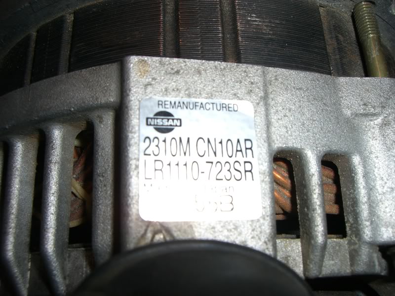

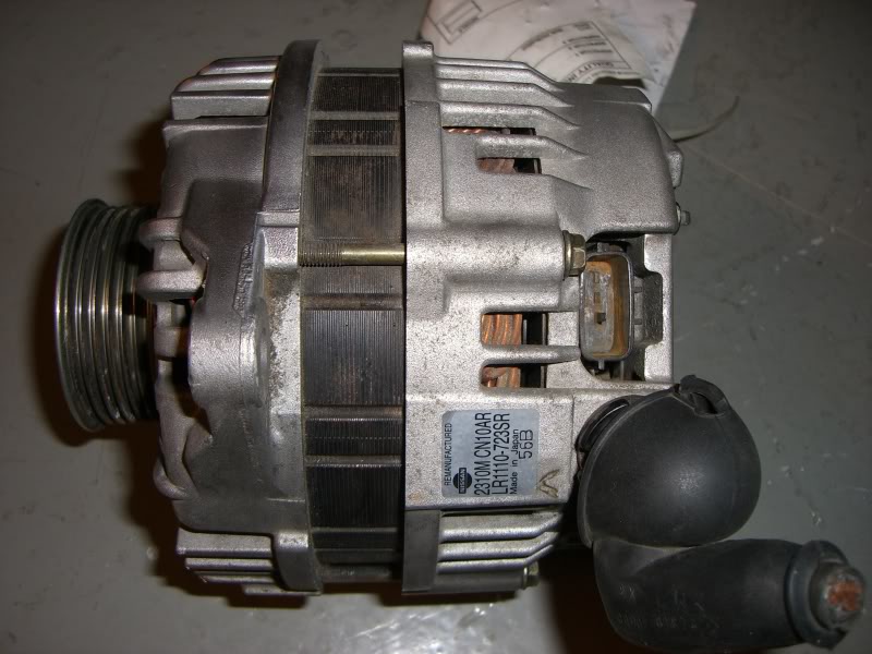

ok so i got the murano alternator today and what happened is they sent me the wrong one, i got one from a 2004 murano which is still the same but its older and has more miles and i was still willing to use it but then i realized it has 1 pin, i guess the other pin broke off so i spoke with the seller through eBay and they admitted to sending me the wrong unit and they're gonna send me the right one hopefully this week. so in the meantime the alternator looks just like my maximas alternator, i will let you guys be the judge of that though ill take pictures and post em up tomorrow
Old Jul 31, 2012 | 03:58 PM
DjHackStyle's Avatar
Posts: 972
From: Bronx, NY
just some FYI
the 2004 murano alternator also came with the plug on it from the car side, so removed it and i compared it to my maximas plug, and it looks different! however i disconnected my maximas alternator and i inserted the murano plug into my maximas alternator and it fit and even clicked in, perfect! looks a little diff but it fits.

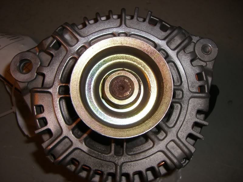

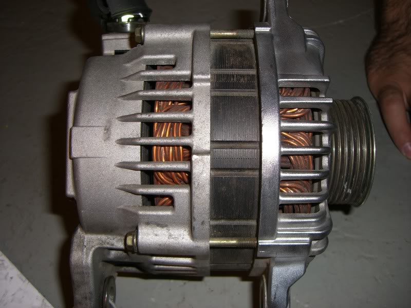

so this is the murano alternator, same or not the same as maxima 5.5th gen?
keep in mind the pin broke inside so it should have 2 pins
Old Aug 2, 2012 | 01:29 PM
aackshun's Avatar
Posts: 5,398
Yup that'll plug in and mount to the car.

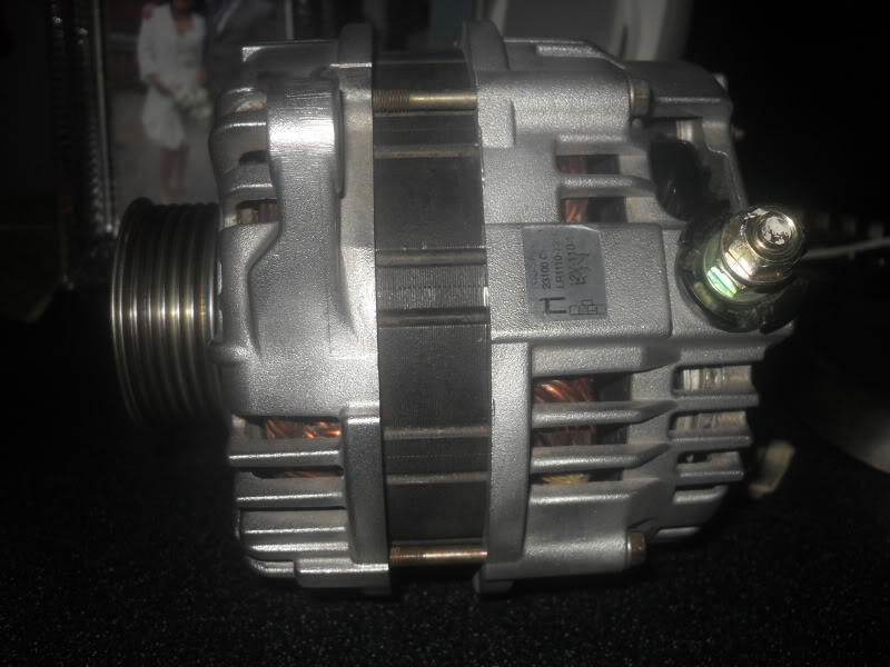

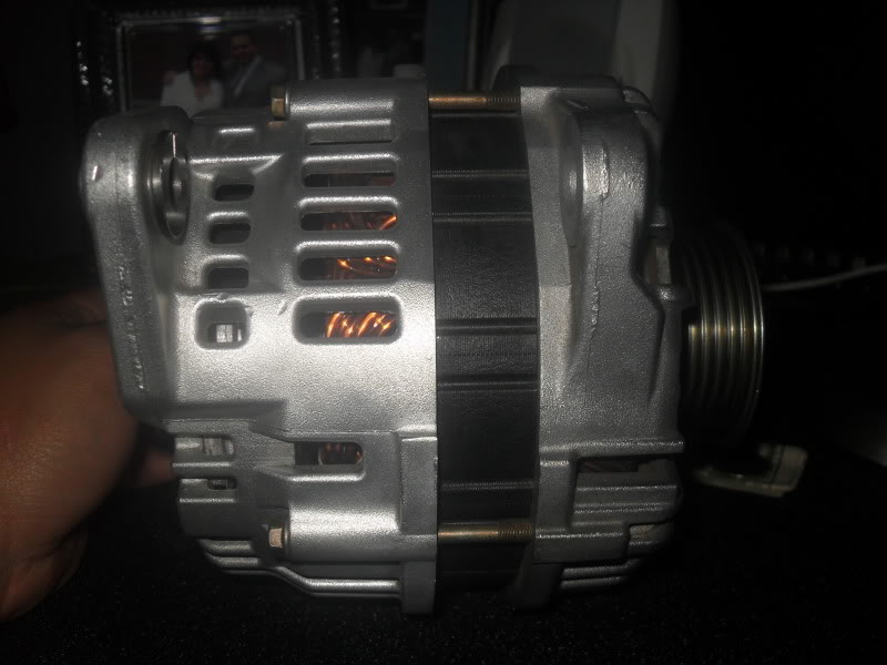

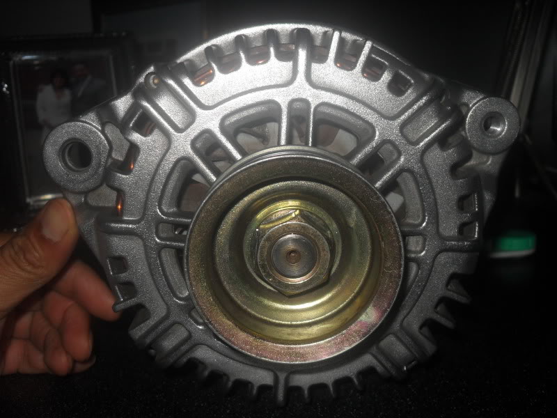

ok so the correct murano alternator came in and i took the liberty to take it apart and clean it up and pass it through a brush wheel i think it looks like one of those rebuilt ones now all clean. this model is actually an oem unit and not refurbished like the previous one.
Old Aug 7, 2012 | 05:18 PM
Posts: 972
From: Bronx, NY
i also went to autozone today and got it bench tested! the girl doing the testing didnt know where to connect the positive and negative so i helped out but if she would have done it wrong it might have burned out i guess?? anyways if anyone else goes to AZ for testing make sure they hook it up right.
and the alternator passed the bench test so its good! will be installing sometime next few weeks cuz i blew my rear shock ?
thats more important right now

just want to update you guys, i replaced the alternator on monday and it fits like a glove, it fixed my issue of my dash lights flickering at idle. its confirmed a 2007 murano alternator fits my 2003 maxima, theres no advantage of it being from a murano its the same alternator its just an alternative to buying a newer used alternator (07 vs 03) and murano parts are cheaper than maxima parts for some reason.
