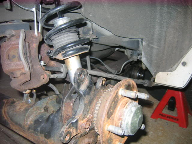

Old Aug 17, 2012 | 06:00 PM
Maxident's Avatar
Joined: Oct 2010
Posts: 87
From: West Chester, PA
Some pics of current state
Size:  30.5 KBThe pride of the neighborhood.
WWhere are my bolts!!!!?????

Yes, thank you.
Originally Posted by knight_yyz
That would have been great, but I didn't have one. Guess it's another trip to the tool store...

Pardon my ignorance, but I can't figure out what this tool is! Shed some light?
It's a nut splitter, I could have just broken the nuts off the bolts instead of sawing through the bolts. The bolts were ordered from Courtesy on 8/13, still haven't been mailed to me. Don't saw through the bolts if you're doing this job!

Wow, didn't even know this existed, but really awesome that it does!

I am currently in the middle of replacing the Rear Trailing Arm bushings with the Energy Suspension bushings.
After replacing all the Struts and mounts which didn't solve my rearend clunking - my next step was the RTA Bushings.... Neither of them have leaked out or even have cracks - so I hope it solves my problem.
I did not remove the rear beam completely - but I did take off the lower bolt to the strut which helps with being able to move the beam and trailing arm a little easier. Started drilling around the metal insert in the bushing with a drill - but tried my rotozip with a drywall bit and it works pretty good - stinky smoke but you can cut a nice circle around the insert. Had to make circular cuts on both the inside and outside of the bushing, it can be pushed out easily. Some advice is to make the circular cut with as big as a circumfrence as possible because the metal sleeve has more mass inside the rubber bushing - it will make pushing it through easier.
I also used the rotozip to clean out the remaining rubber from the inside diameter of the trailing arm - it worked great for this as well. I suggest cutting the remaining rings with a hack saw or sawzall - they will pop right out. I got one side ready for the new bushign , which I will press in using a long hex bolt, washers, wood block and a PVC pipe section. Hopefully everything goes smoothly.
I've got around 3 hours into the job and should finish it in another 3 hours. With all the writeups and hints on this site - you should be able to handle this fix. One more last piece of wisdom - if you have a torch heat up the bolts a little so you don't snap them - Don't be a Jack*** like me.
If this doesn't solve my clunking noise - I don't know what else there is to do.....
