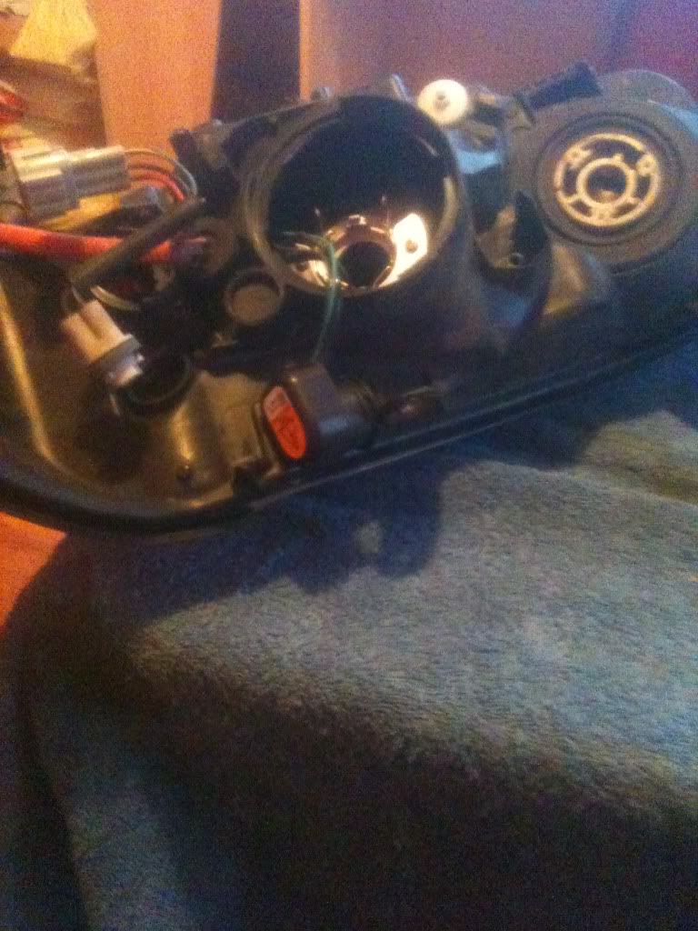

baking head light quick question
Old Aug 24, 2012 | 04:26 PM
heyhi's Avatar
Posts: 115
Size:  151.9 KB">Name:  Picture.jpg
Size:  151.9 KBIm ready to throw this in the oven, i took out all screws n bulbs but it looks like more should come out. theres a wire that goes in the housing and the part that hold the hid bulb. am i safe to throw this thing in

Old Aug 24, 2012 | 05:59 PM
Should be safe to go in.
Old Aug 24, 2012 | 06:12 PM
Brudface's Avatar
Posts: 361
From: Ottawa, ON
Its all safe to go in, just make sure it either gets tucked away into the housing, or zip tie it to something. There is no way to take out the Ignitor and corresponding wires stuck to it until you bake it open. Like I said though make sure none of the wires are able to fall out and touch the wire racks in the oven.
Old Aug 24, 2012 | 06:44 PM
Genes1s's Avatar
Posts: 1,162
From: Vancouver, WA
Take that high beam rubber cap too along with little U shape rubber hose air circulation.
Old Aug 24, 2012 | 07:29 PM
mrjasonlyrics's Avatar
Joined: Oct 2011
Posts: 1,245
At 200degrees F nothing would melt. You could spread foil paper on the shelf to prevent the wires from coming in contact with the heat rods, other than that you should be good.

you could put a damp rag down on top of the tray that you put in the oven to assure nothing gets burnt......
Old Aug 27, 2012 | 07:28 AM
DjHackStyle's Avatar
Posts: 972
From: Bronx, NY
ive always put a wet towel inside the oven and then put the headlight on top of the towel so the headlight doesnt touch anything. this was on previous cars
Old Aug 27, 2012 | 07:43 AM
Joined: Oct 2011
Posts: 1,245
Ya'll panicing too much. 200 degrees F won't melt anything. It's just enough to melt the selicone to open it. The only how things will melt is if loose connections touch the actual heat coil or the walls of the oven. Resting it on the tray is fine, just tuck away any loose wires and connector
