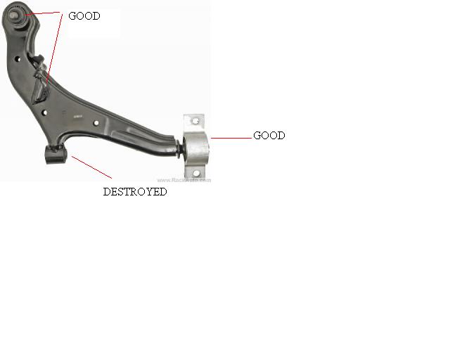

I'm pretty sure the nut on the "DESTROYED" part is larger than a 24mm. (Tried to use the 24mm that I used to change the PS banjo bolt)
So the castle nut is a 19mm?
I dont need a ball joint separator since I'm changing the control arm as a whole?

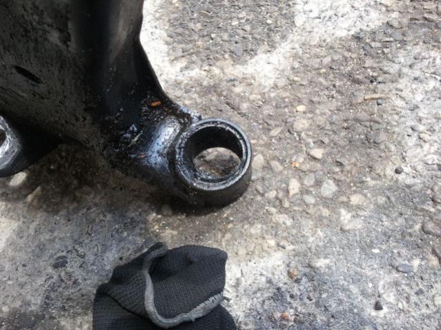

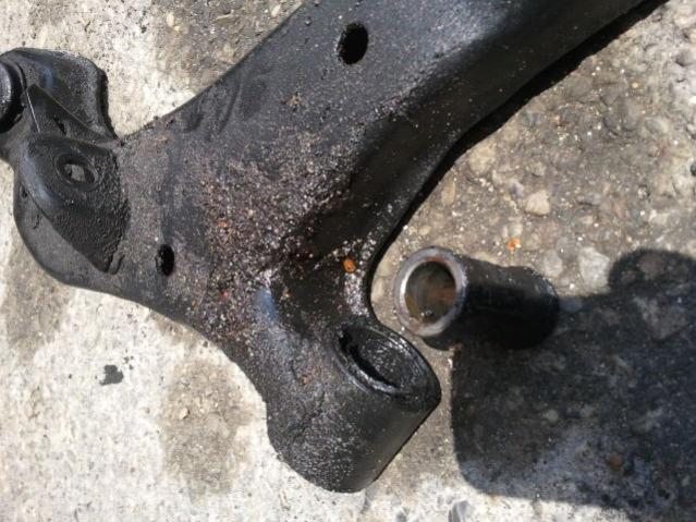

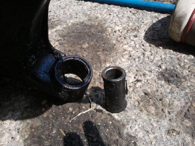

This is just one of the issues you will encounter if you don't get the leaky PS/BS hose replaced or repaired.
Attached Thumbnails Control Arm Removal and Install-2012-09-01-13-58-45.jpg   Control Arm Removal and Install-2012-09-01-13-59-08.jpg   Control Arm Removal and Install-2012-09-01-13-59-31.jpg
