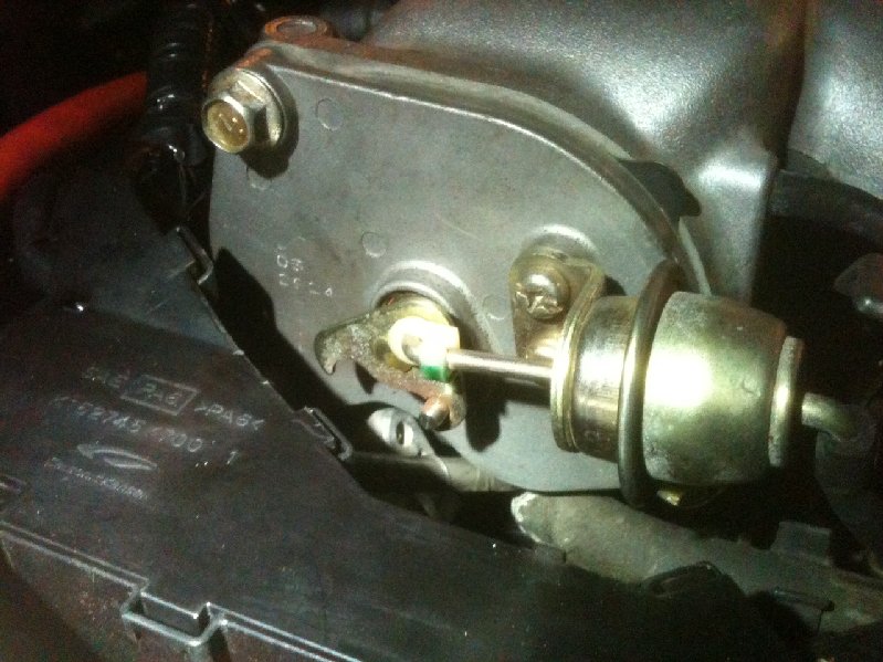

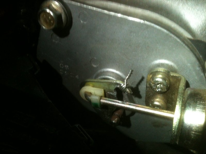

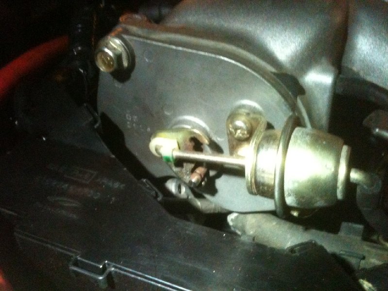

Found VIAS stuck open..... There is a groove worn into the shaft, and the 'arm' rusted into it. Freed it up and still got stuck. Added safety wire for a temp repair. See pics. Car drives completely different, and I can't detect pinging anymore... I think this has occasionally happened in past, then at some point it rusted together... Works fine until I buy parts.

Might look into the NWP VIAS block off plate and get rid of that crap altogether. Looks to be on back order until the end of January though.

Once you break off the metal, how are you going to seal up the hole where the control rod comes through?

Until 15lbs of vacuum sucks in the rtv or vacuum cap into the motor. Plugs a valve. Then bends it. Breaks the piston. And bam motor toast. Or spend 20$ or whatever on a nwp. Or cxjperformance bop and have it look clean. About the cheapest mod you can get for the maxima....
Old Dec 22, 2012 | 05:24 AM
TunerMaxima3000's Avatar
Posts: 5,545
From: Ontario, Canada
beat me to it.
It's -20 to -25 PSI of vacuum sucking in, anything you put in there will get sucked into the engine bay unless done properly.
ITS $20 for a BOP.
If you WANT to keep your VIAS, get one off a member that deleted his and has it in their basement, or go get one from the wreckers.
If you want to DELETE it, get a block off plate, or take the old valve to a professional to cut it off and weld the hole shut (which will cost you more than $20 probably, and look ugly.
