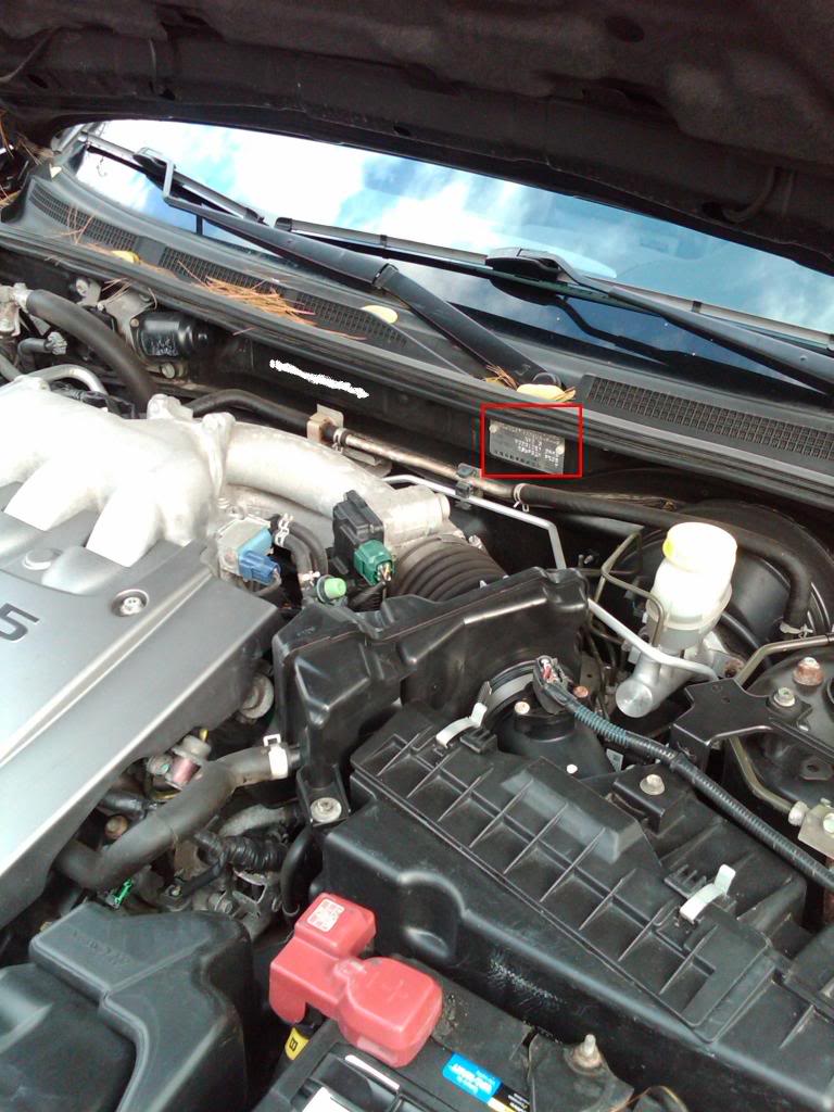

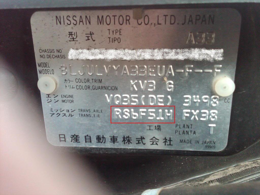

Last question... what one of these to I need? http://www.summitracing.com/search/m...=transgo%20hd2
EDIT: More specifically... Thinking it's the RE4FO4A-HD2 or RE4FO4B-HD2
Originally Posted by cjandura
I wish i could find a shop to do mine everwhere i have gone to get it installed they said they had to drop the trans and that was the first sign that they had no experience and didnt know what they were doing
My step-grandfather-inlaw (there's a mouthful) said he could install the kit within a few hours. He has a full shop at his place with a lift and everything. He has a lot of experience with American muscle cars, but not too much with imports (minus classics). Once I figure out what he's going to charge, if he can in-fact do this, and how long it will "actually" take, you up for driving down to lower Delaware for a day? I'm personally more interested in installing this myself with some "guidance" when needed. If interested I'll keep you posted, let me know.
Old Apr 1, 2013 | 06:57 AM
NmexMAX's Avatar
dot dot dot ...
Posts: 34,576
From: Santa Fe, NM
Yours is the "B" at the end, if in doubt, check your tag on the firewall.
Old Apr 1, 2013 | 09:28 AM
JWatZ's Avatar
Joined: Feb 2013
Posts: 660
From: In the 3OH2
Thanks NmexMAX, just ordered it!
