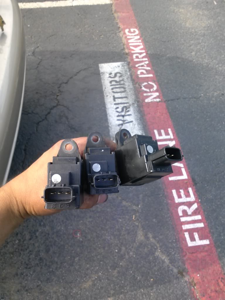

you need to replace all 6 coils with the gray dot coils from Nissan... do not use aftermarket coils. replace all coils with OEM gray dot nissan coils and move on with your life... I did that almost 60,000 miles ago and never since had a single problem with misfire

Recently (month ago) I faced the exact same issue with cylinder 3 misfire. I experienced the exact scenario... when its cool in the morning it starts and runs like new. Once its warmed up or drivng home in the afternoon.... chug chug chugs along.
I got the SES light intermittently and finally took it to my mechanic. Turns out the cylinder 3 coil was bad. I had him change coils 1, 3, 5 (the rear 3) bc it takes alot for them to access the rear cylinders and I'd hate change one now, and have to pay the labor again to change another.
Lng story short, I also had all six spark plugs changed as it has 109k miles and I assumed the previous owner never changed them.
I am pretty sure I did not get oem coils... I didnt read up on my issue enougj before having the work done. I would follow the recommendations from everyone here though and get OEM.

Search around. There are a bunch of threads on replacing coils. It is very simple. You literally need to take off the bolt and pull it out and replace it.
As for testing the coils, you aren't going to get any shop to test them. There are testing procedures on the org using a multimeter. That is not foolproof though. Also, the numbers you get may not match the numbers posted. The key if you test this way is to determine if one of the coils is way out of whack with the others.
Do NOT get autozone coils. I've had terrible experiences with getting bad coils or getting ones that die quickly. Last time I dealt with this, I got 3 separate bad coils that I tested with my multimeter and knew they wouldn't work because the impedence was off.
I would get one good coil and then simply start swapping them out in the rear until the problem goes away. If no swap fixes things then you need to take a close look at the replacement coil. IMO get it from Nissan or what I did - the junkyard for $15.
Doing it this way will save you a ton of money.
Size:  86.7 KB i got these a long while back when i too experienced misfire code on 5(it was swimming in oil)
I guess for the next time I need to find a way to release the green clip and separate from the housing. Maybe I too have oil in there causing the intermittent misfire code 5.
