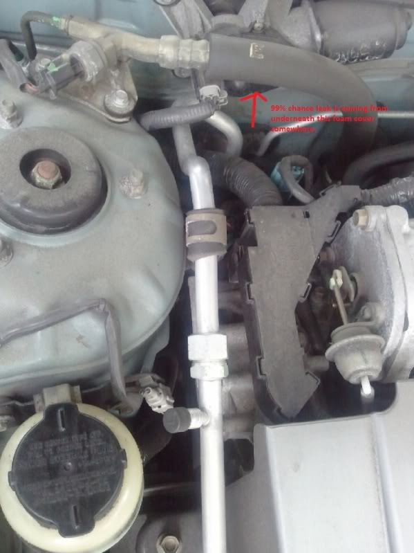

For leaking power steering fluid, look at this hose in the rear passenger side of the engine bay. Very common item to go bad - the high pressure hose. If it is, spend the extra money and get OEM instead of aftermarket unless you want the pump to whine.

When that bump leaks it can drip on the control arm bushing which may cause the jerking to the right you are talking about. Obviously, if it is the bushing, don't replace it until after that hose.

I had the same issue with the jerking on another car. Just replace the lower arm control bushing, saves big bucks but is a PITA if you don't have the right tools.

Hey guys, thank you for your input.
WHen I drive, sometimes (Not always) out of nowhere, the car will just jerk right, (the wheel that is) i feel like a "bump" coming from the front.
Sometimes it will jerk left then right.
My control arm bushings are soaked from leaking fluid.
FOR SURE I AM LEAKING fluid, but I am unaware as to if I am leaking anything besides POWER STEERING.
I will replace the entire control arm actually which included bushings for the same price of just purchasing bushings themselves.

THANK YOU!!! I will be looking into this tomorrow when it is light out.
Sir... or Ma'am... You are a GENIUS!
Turns out my control arm bushings need replacement...
and here I just ordered a new rack and pinion...
