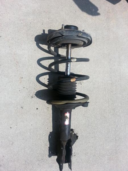

And just for kicks because i like photos...here's the struts in the box, one of the old blown one removed and one of the new ones put in.
