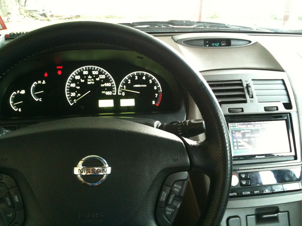

Mileage Matches Body Fuel, Temp, Speed, RPM's all work im happy with myself lmao

Its pretty much plug and play except the illumination part you have to follow the LED write up provided in this thread. I could have wired it up to work with the stock EL Tube but the LEDs looked way better then the stock greenish color

I've never seen anyone do it with that cluster, I've seen a few guys go to the much better looking I35 cluster. Can't see the point in jumping to the I30, it isn't really any different looking. Either way, congrats, light output looks fantastic, nice work!

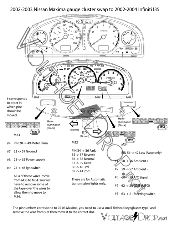

My boy already has this cluster in his 02 6MT I kno how to do this for the 02-03 but the 00-01 is the problem the coolant gauge for the 02-03 is read somehow directly off the ECU and the Coolant gauge for the 00-01 is read off the coolant temp sensor.. Some guy off voltage drop posted a write up for this here it is..

If somebody could help me figure out the wiring with the TEMP gauge I can do this no problem.. Ima hit up that guy you suggested
