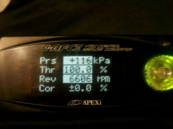

sea level atmospheric pressure = 101,325 PA or 101.325 kPa
So let me rephrase the question. Has anyone else achieved greater than atmospheric pressure N/A? My goal is to break 130 kPa and chirp 4th. But keep going if you think it's still funny. I'm really scared of a "400 hp" turbo haha not
Beware the beast

You are saying that your car is boosting N/A?
Don't know if supposed to be a joke, but I'll post anyway. :P
manifold vacuum has nothing to do with how much power you're making.
Just intake restriction. Other then ram air you can't go over ambient pressure..

It's the voltage interpretation of the AFC since the VAFC is designed for Hondas, which do not use a hot wire, and use a MAP sensor instead.
Get a SAFC, they read in MAF %, little better correlation.
And, even if "ram air", it doesn't have an effect until speeds close to mach 1, this has been discussed here before.

so it's not even a pressure reading (I didn't think AFCs had a pressure gauge but wasn't sure).

The kPa reading is from the manifold pressure reading on the stock ecu. I am using dynamic supercharging to increase the amount of air in the intake and have tried many different setups.

There is no MAP sensor on these cars. As stated prior. Please stop.
Not sure if trolling or serious but 95-99 MEVI's and 00-01 VI's have dynamic supercharging, 02-03's do not have such features. Even then, ... I'm not even going to try.

95-01 cars do have a BARO sensor, however any VAFC installation that I see splices the harness directly to the MAF wiring.

GReddy boost sensor will read more accurately than your VAFC would.
In all seriousness, you should see positive atmospheric pressure if you incorporate some type of ram-air intake in a high pressure area (foglight/bumper area) at higher speed.

when it comes to working on cars that i'm thinking I'm getting kPa readings from a device which has no pressure sensor hooked up to it. Noob.
Ok I get it... That thing is interpreting some sort of signal from the maf into kpa
It looked pretty bunk, and it is.
Making boost n/a
sicxspd: What is that thing reading at with the engine off or at idle?
