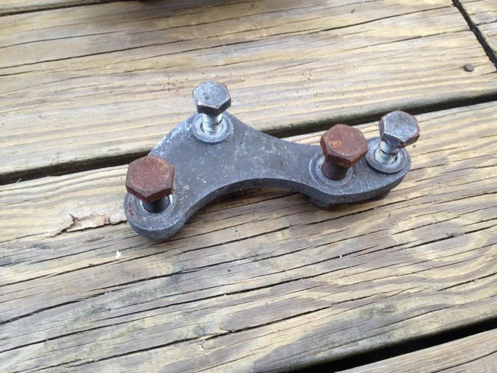

Need some help here. I searched and couldn't find a thread with the specific answer but I was running this on my 3rd gen Altima (similar to the 6th gen max frame)
91 300ZX Aluminum 30mm Calipers
Blehmco Caliper Relocation Brackets
Goodridge SS Braided Brake Lines
Powerslot Slotted/Cadmium Plated Rotors
Hawk HP Street Brake Pads
My question here is does anybody know if this exact setup with my Blehmco relocation bracket for my alti would work on my 5.5? By looking at the 2 brackets they look identical but don't know the technical side of it. Is it the same bracket used?
This is a pic from someones thread in the classifieds section and my bracket looks just like it. Just not sure of the measurements going from the 3rd gen Altima/6th gen maxima to the 5.5 gen maxima.

The part numbers are different for the front brakes, but it seems they kept the same bolt pattern between 5.5 Maxima front from 2002 all the way to 2008 350Z and G35, and a lot of people are running the 6th gen setup, so most likely the pattern is the same on the altima. If you have the brakes, the best way would be to test fit them

Just an update...The blehmco brackets from the 3rd gen altima fit without issue.
