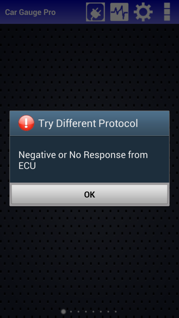

Originally Posted by JWatZ
Just tried the ABS test on the LF solenoid. The up, keep, and down functions are working. This was after a brisk drive with the car running. So try it again at operating temp with the car running.
Still doesnt work, from my research theres 3 different ABS units
Auto W/ TCS version
Auto without TCS version
Manual version
So i have a 6Spd maybe that module doesnt support testing

Abs sensors on automatic and 6 speed a completely different. They send different signals.
The 6mt produces a sine wave generated by a coil and a bar magnet.
The auto produces a square signal produced by a magnet and an IC.
On the 6mt the greater the speed the higher the voltage, on the auto the frequency of the square wave increases.
On the thread DJ posted on the other forum the guy says the signal is on a certain pin of the obd2 port which has nothing to do with the problem.
