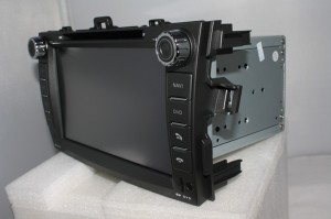

So This is the deal i have a 2002 Maxima with the stock "Bose" system. and i was just given a new headunit which is a Koolertron 8 Inch Car DVD GPS Navigation System - QL-CRL703
and i really wanted to install this bad boy in... supposedly its for Toyota Carola i belive... Anyway.. I wanted to really find out.. If it were possible to install this and have it fit properly .. .. Since the Climate Control. is there.. Dunno if this unit would be able to control the climate control as well.(just a dream).. But anyway.. What do you guys think. or suggest.. Would it be possible for me to do it.. Because i really wouldnt want it to go to waste. Ive like added an Aux port and hard wired Usb to bose .. and like i have to redo it and its just getting to be annoying and wanted to add some new speakers maybe some Apline SpR-60's and a Alpine SWR-12D2 Sub.. Amp Im not sure yet about what to get.. maybe just stick to getting an Alpine AMP as well. Obviously this setup is not like set in stone to be honest its. just what i was looking at.. and done some reading so got the idea and suggestions from around here.. But If anyone has something else they would do.. let me know.. Cause im assuming i cant really use the Stock Speakers and Sub with Amp and get the most out of the system.. I know a new Headunit def makes a difference compared to stock (which i dont really think is terrible ,buts that just my honest opinion).. Just getting annoyed and im a real Audiophile.. I Produce music and like LOVE ME SOME Quality sound.. If my studio room sounds great.. and My car is actually where i test out my tracks to see what they would sound like.. since studio monitors and acoustics in room you cant always get the real idea of whats going on . then bring it to the car system and some sounds are just heard very differently.. Anyway getting off topic..

You have picked a real project for yourself. Every aspect of installing that unit is going to be a custom, hand made, one of a kind thing.
Is it impossible? No, nothing is impossible. With enough money and resources, you can do it.
Will it be easy? Absolutely not.
Mounting that in the dash will be a small engineering feat. Nissan does not make their radios to the industry standard din or double din dimensions. Nissan radios are bigger. And the way the radio mounts is unique to Nissan and no other manufacturer. That's why you need an adapter kit.
Ditto for Toyota.
And there is no Toyota into Nissan adapter kit.
And then you have the electrical connections. Did you get the connection pigtails for the Toyota radio? Do you have the Toyota wiring diagram for the radio?
Hardly a practical, realistic thing to do. I bet your so-called buddy is still laughing his azz off that he suckered you into taking that radio instead of a cash payment.

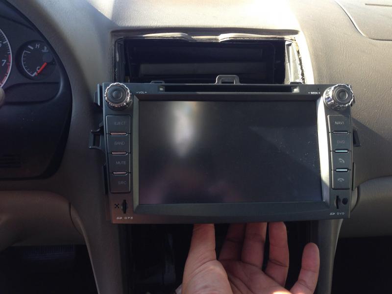

So. I took my stock head unit out. Only cause I wanted to resolder aux port to board. And figured lemme see if this new unit would fit in there. And took some pictures of what it would look like and how it would fit
It's def really just Slightly a little to big although maybe. Just maybe if I shave off each side it might fit a little better. It will probably protrude out a little bit though. And that's probably not smart if I could sell it and get some money for another unit. We'll see what a shop says. I'm sure they won't want to mess with it. They'll prolly just say nope it won't fit. Buy another one from us that will fit

You think ? Lol. Totally. Like I don't know why I'm so in denial About just saying eff it. Instead of sitting here trying to think of ways to make it for somehow. I'll post up some more photos of what the sides look like and where there's a problem. I mean it's not completely impossible to do. But why go through all the trouble. (Well money I guess. ). Because I don't currently have a few extra hundred bucks to gets me a new one. I need to just get rid of it and sell it and call it a day. Any money I get. Will go towards new gear. I'm just not so happy with the quality I'm getting from my stock HU. Aux port. Volumes lower then the tape player adapter. Which still bugs me out. I can hear it blatantly and SPL meter confirms it. And I've read all bout it. Probably skimmed through a bunch of Threads on it. Dunno if there's anything I can do to fix that. Or using connecting it to cd changer with silent cd (can't remember where the thread was on how to ). all I want is a friggin quality sound. Without no volume peakage distortion. It just annoying.
The one photo you posted says everything that needs to be said. It won't fit into the Maxima's dash. I say don't waste any more of your time with this. Post it on Craig's List and get rid of it for a few bucks.
