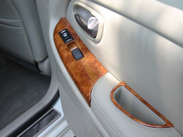

I wonder if the front door switch covers and be fitted to the back to have switches on the rear door?
I was thinking the back of the console but, this makes waaayyy more sense
Old Nov 14, 2014 | 07:51 PM
nestorlugo's Avatar
Joined: May 2013
Posts: 1,584
how bout swappin the door panel?

Old Nov 14, 2014 | 09:11 PM
King_Ten_Ahead's Avatar
Joined: Dec 2013
Posts: 684
From: Indiana
Lol! The only thing thats kept me from getting the door panels is that i cant find non ripped ones

Ive got the wiring completed now, the only thing i have to do is attach the power wire to the add a circuit i used in the DTRL fuse slot. Theres two fuse spots in this add a circuit, i know the 10A goes in the one..
What size would be best for the other?
Online ive seen some people add heated seats in the back and use 7.5A.. but those werent in maximas..
id rather ask you guys than experiment and turn my Max into a nice, toasty, campfire

In the I35, Nissan used a single 10 amp fuse that served both seats. I don't follow what the other 2 fuses would be for. I'll take a look at the I35 wiring diagram again and see if I missed something.
I looked at the 2003 I35 diagram and the only fuse used is the single 10 amp fuse in the dash panel fuse block. If you are tapping into a fuse already in the dash panel fuse block, then you don't need any other fuse. Do these extra fuses plug into the wiring of the add a fuse thing you bought? If so, they would be duplicating the fuse in the dash panel fuse block and are not necessary.
Okay thank you! This is what i figured myself, however since Id never used one i wanted to double check. I just wanted to make sure the DTRL fuse doesnt power anything else.
I won't be much help ,sorry !but when you get it all sort it out plz do a write up, my kids will thank you since they lil butts are always cold in the winter time....
I thought about it but opted not to since i figured most people wont ever use it..
But since you asked, and im a nice guy who doesnt want your kids to get frostbite on their rear ends.. ill post one up within the week if all goes well.
If I forget, remind me lol

All done with this job...
