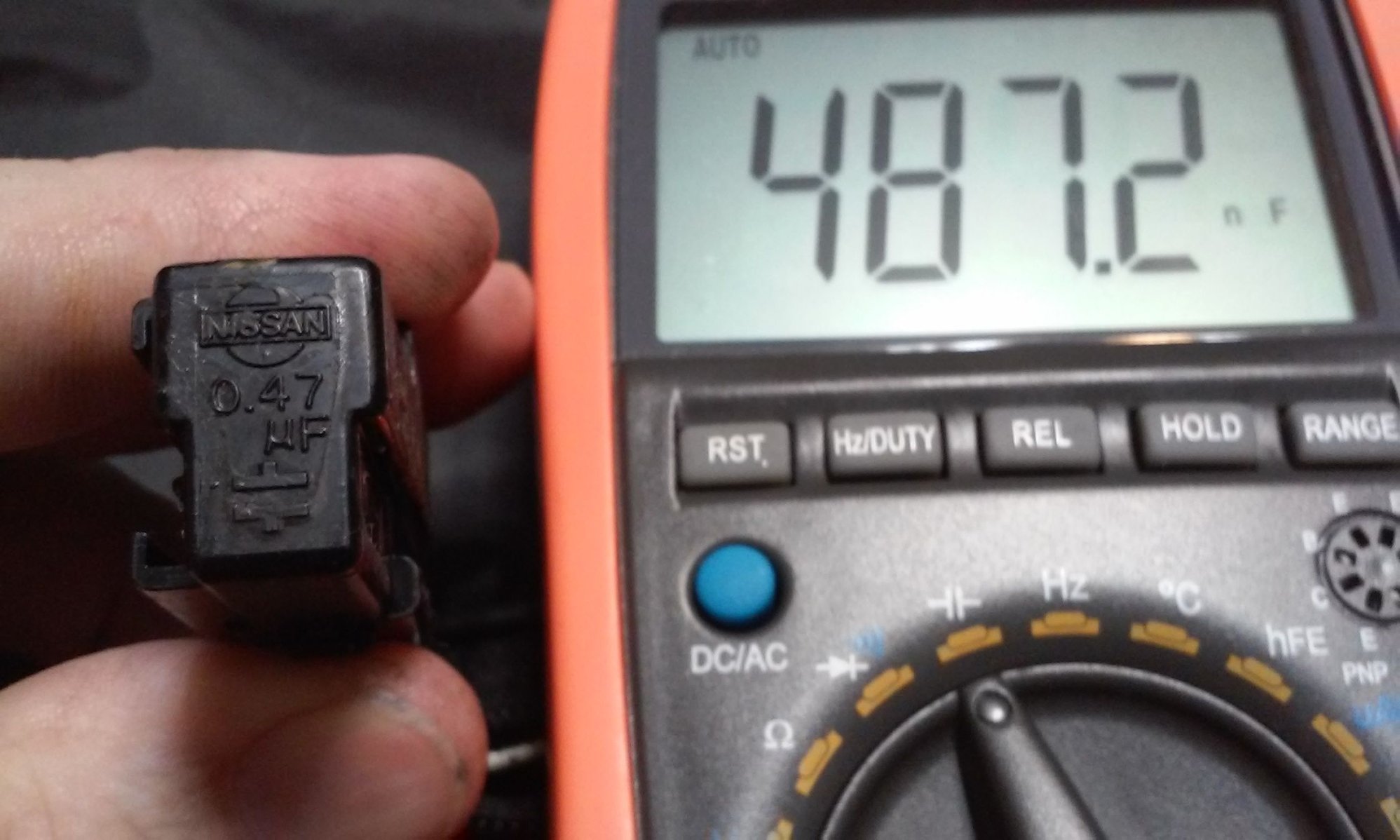

I don't own it anymore but a good friend of mine does. After an exhaustive search of the wiring diagram and lots of probing and testing it has been fixed!!!! Apparently there is a box within the wiring harness above the front bank of cylinders. My buddy described it as a condenser with an internal diode....don't ask me but he found that it was burnt....melted if you will. A replacement was found within 10 minutes at the local "you pull it" and it now purr's like a kitten.

I know this is an old thread but I'd like to expand on markiezee68's fix above and then ask a few questions since I'm having the same crank-no-start issue. Since I'm having the same issue I am trying to keep all the post about this issue together. Please know that I'm not trying to hijack this post but help keep all the information together in one spot.
The item in the picture above is a condenser (.47 uf capacitor). It doesn't appear to have a diode in it.
Snippet of ignition system wiring diagram.
Here is a better picture of what it looks like in the car. I'm showing it without the tape that is over it when you first remove the engine cover.
I removed mine and tested it with the capacitor test on my multimeter. It is a .47 uf (micro-farad) capacitor. Mine checked at .487 uf so I assume it is good. *Note: my meter reads in nano-farads so the reading of 487.2 converts to .487 micro-farads.
