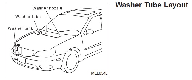

Hey guys. Over the winter the washer fluid in my car (which Walmart said was good to -20 ) froze and cracked all my lines.
Anyone have a diagram of the hoses or anything that will help me buy the right parts BEFOREHAND taking things apart. The job seems simple. I just want the hoses in hand to replace. Other than that I think I can get away with only taking plastic pieces off and reaching the hoses.

Here's the washer hose layout from the FSM, page 167 of Electrical System.

And I doubt there's a part number specifically for the hoses. I'd just tear a piece of the hose out and use it to find the right size, and then buy whatever length of replacement hose you need. Then just follow the hose from the washer tank to the nozzles and replace the old hose with your new one.

Exactly what I wanted. Nice and simple. Thanks!
