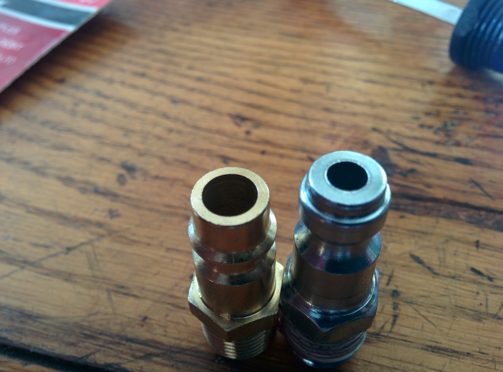

Here, take a look at this tiny hole!
hiflow vs standard.
hiflow vs standard.
hiflow vs standard.
hiflow vs standard.
