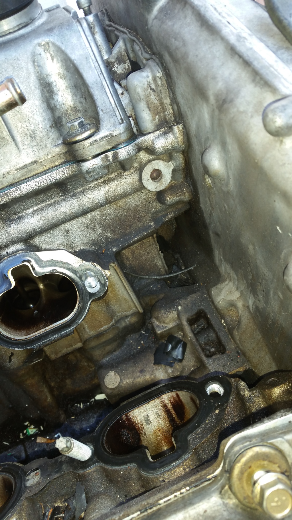

Ok so I don't think either or have to come off and all you need to remove is the air box and you get a good look at them!
If you're referring to the fp cyl head bank2(closest to the radiator) it can be accessed at a weird angle, but taking off the water inlet tube is probably necessary...
However if you need to replace bank1 fp you get a clear path,you might have to take off the tb (throttle body) idk the engine on my car didn't have it on at the time
Bank1
Bank2

Thanks for info, but its leaking on passenger side of engine near the altnernator and ac compressor. The guy in the old thread said its right by the thermostat housing which is on the passenger side of the motor. Could see if the freeze plug is in that area on your motor?

Great i just saw ur pic after i posted!!! That looks like that should be it!!! Thats the vq30 right?

This is on the opposite side of the engine tho' , I didn't look up front...
Yes is a 3.0

The bank 1 freeze plug is on the passenger side of the motor right? i believe thats the one thata leaking!

Both of these are on the other side ,

Kind of hard to see but i think thats the front passenger side of the motor.

Yes it is but that's with the timing covers off!
Damn you better hope is not that one...

lol i know right, but unfortunally thats the one that popped out! The guy in the thread said he had to remove the intake plenum and lower intake to get to it. I was hoping you can give me some insight, i pray i can do this without pulling the cover. I wanna know exactly whata in store before i get started.

Ok I gotcha, both the uim and lim are off on the engine that's on the stand, when I go over I'll look !
Thanks a lot, please get back to me on that, Im waiting to hear back from you before I start.
Old Mar 5, 2016 | 02:31 PM
nestorlugo's Avatar
Joined: May 2013
Posts: 1,584
I WAS able to feel the plug in the small opening between the head and tc, so yup in theory you will be able to access it from there.
BUT!
the space in there is just too small to get it out (imo) ,unless it came completely off than I can see you having the time of your life trying to reach in there with something out of a star wars ship to pull it off!
However if you can get it off this way ,I believe you can get enough leverage to squeeze a new one on there too!
Just for kicks I poured a little water on top there and it drained really fast between the head and the thermostat housing, I guess that's where your coolant rushes out of,so you in the right track for sure
