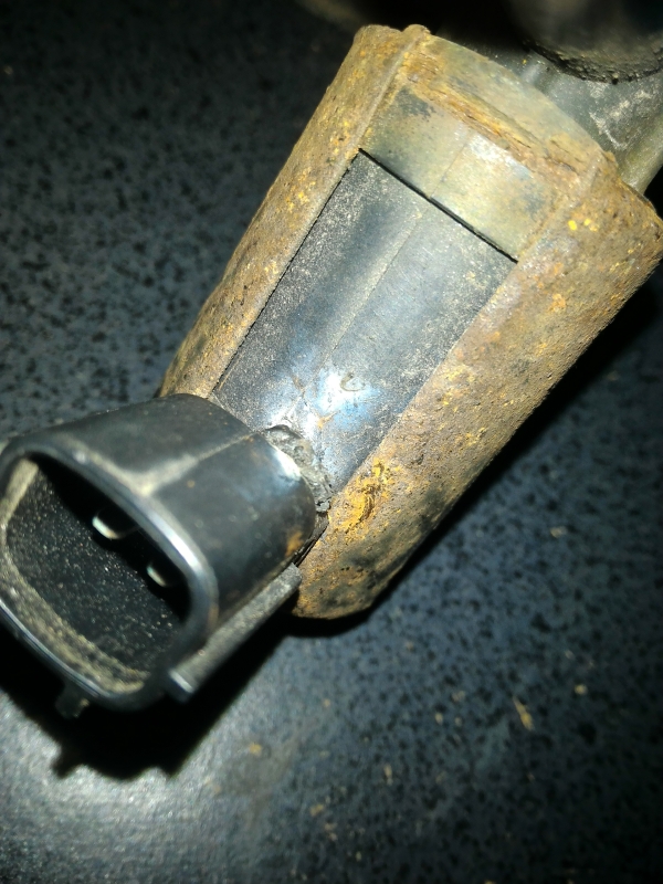

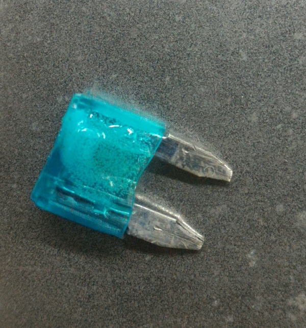

was driving my 01 on the highway and the ECU literately went up in smoke (along with a melted cylinder 1 ignition coil)! Thick nasty smelling smoke started oozing out. IACV Tested out good. Computer was replaced and re-keyed and the same thing happened again on the highway (ignition coil again too)... The culprit..bad Evap canister solenoid (also 15A ELEC Parts fuse melted, not blown). One more thing to worry about on these cars.
Attached Thumbnails ECU burned up on highway-p_20160320_170145.jpg   ECU burned up on highway-p_20160315_163334.jpg

Well, that's what they have done. However, to control the "pluming" into the fuel system they have used an e-valve, and it looks like the e-valve has shorted, taking ECU with it. If you eliminate the valve, the pluming would be uncontrolled resulting in driveability problems.
The only solution is better fusing. The 15A fuse (#20) used by Nissan will not protect the driving transistor which probably can take 6A at most; more likely, only 3A or so. Unfortunately, you just can't use a smaller fuse because there are too many other things on it.

The fuse blew out all right, the only thing we can argue about is the manner in which it exactly blew up ...... (slow torture vs. sudden blow).
Replacing the fuse will not help - there are simply too many things on it: EC-COOLF, SC-START, EL-ESCD, EC-PGC/V, EC-VENT/V, EC-SWL/V, EC-BYPS/V, EC-VIAS/V, EL-NATS (this is directly from 2k FSM, pg. EL-16).
However, one could perhaps provide an additional fuse. From the diagram on p. EL-16: The power connection forks as it leaves the 15A fuse. The latter six subsystems (from EC-PGC/V to EL-NATS) are supplied via the second fork (R/Y wire). One could insert a fuse right at this exit point; this would require one splice and the use of a fuse adapter such as this one: http://www.delcity.net/store/Mini-Lo...apter/p_810069 .
This still leaves one question open: Will a single 3A fuse (or 4A or 5A, or ... ?) be sufficient to power all six subsystems, while protecting against the failure of the EVAP valve?
