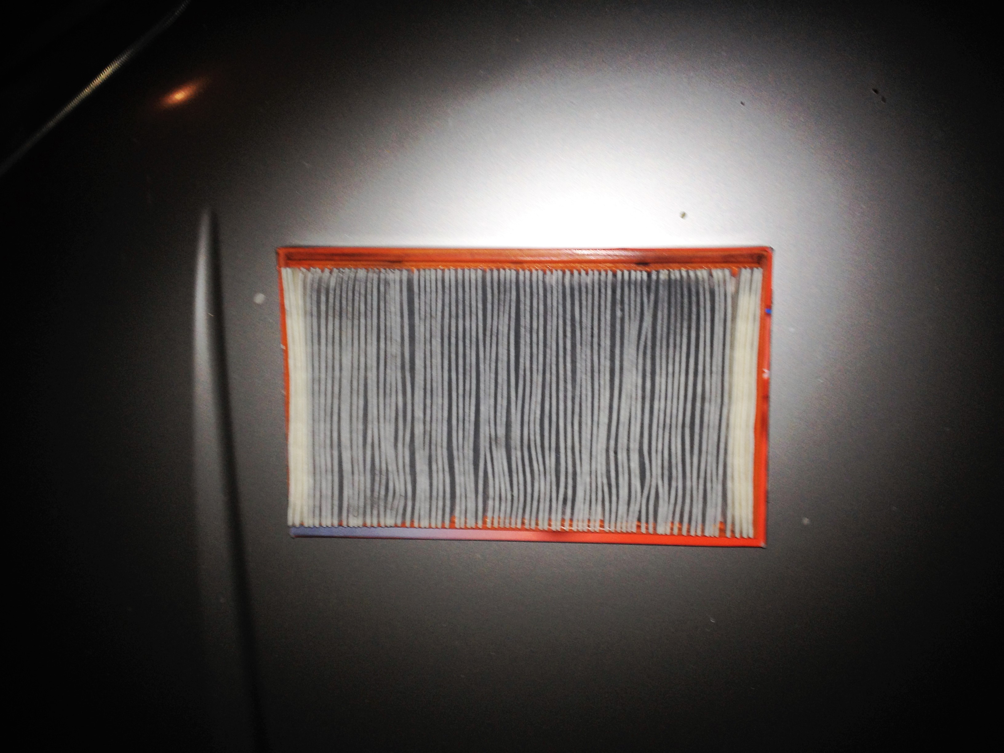

I used to change the thing so much in my last car it looked brand new every time I changed it.
So when I got this car I let it go until it showed some signs of dirt. Well that wasn't too intelligent because it created major performance issues and also my fear is it could've dumped unburnt fuel into the oil + exhaust. This is a 12000 mile filter I left in for 4 years,

Unburnt fuel will kill a cat, so that definitely didn't help it. That's why the POS ones in the 5.5 fail so easy.
Unless it is running insanely rich, then it sounds like there's a leaky injector.

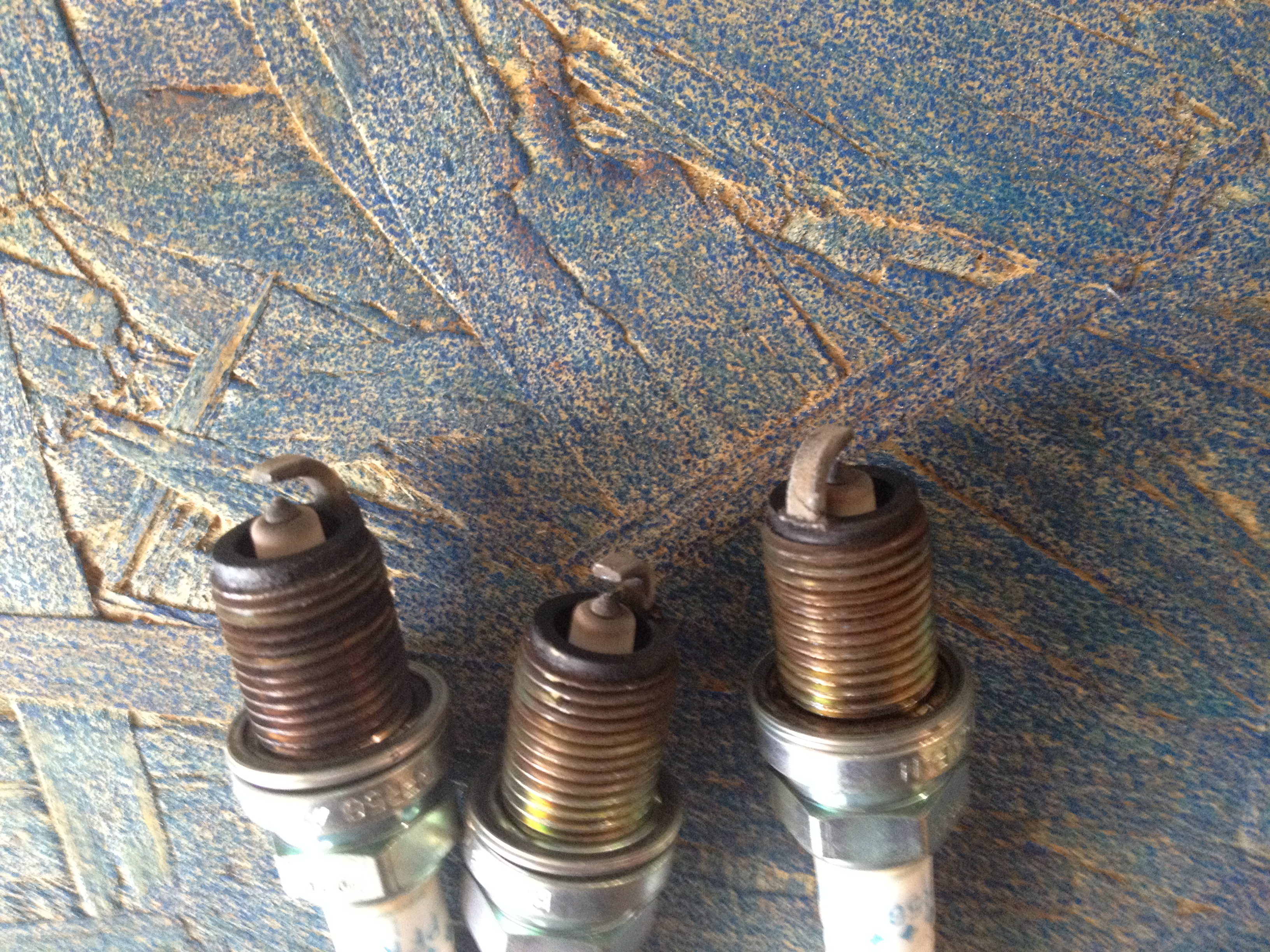

removed old Bougies and replaced with Motorcraft Platinum
Catalyst failure wouldn't leave the oil smelling like fuel though right?
MadMax may be on the money with the plugs being bad because the car has 150xxx miles and I doubt they have ever been changed.
Typically people keep up with the maintenance so you have to ask around to someone who has witnessed the effects of old plugs that need to be changed.

I would have personaly bought the ngk plats for the peace of mind. If your air filter was that blasted with dirt, then there is no telling what your MAF sensor screen looks like. i would blast that down with maf cleaner too see if it does the trick.

Why did you put Ford plugs in a Nissan??
In these engines, NGK or bust. There's a reason Nissan put them in at the factory.

^^^this, but I had an occasion where when I bought my max it was misfiring so bad it was undrivabile. The previous owner had Bosch plugs just installed in it and it ran like crap and smelled like raw fuel. Ngks made it purr again but this isn't the case with everyone.

I was going to but the parts store said Motorcraft was better quality.
I'll contact Motorcraft and confront them if I get a backfire + I'm going to install a new pre-cat after the compression test.
Maybe these members were using crappy gas? What rated octane did they fill up with?

It's not that the motorcraft won't work, they just won't last nearly aslong and have a chance of fouling right up due to crappy spark. If you contact motorcraft,there just going to tell you they won't misfire and blah blah blah, oh and I believe motorcraft is fords line of stuff. I would never choke my car with a ford product.

Believe it or not, there are people out there who pass them selves off as experienced but just give bad advice to people. Just because someone stands behind a parts counter or even calls them selves a "tech" doesn't mean you should listen to them.
The plugs will probably be ok but they wont perform as well as NKGs.

I would assume the gap has to be dead on at .044. I wouldn't use them right out of the box but fine tune the gapping before installation...
had a gapping gauge and even though the parts guy said they were pre-gapped I checked them. I really had to re-gap they were a bit out at .046 instead of .044...

I've never had to regap a ngk in my life, and the misses and detonation from other plugs are probably from the fact that they don't transfer heat as well as an ngk from the cylinder. There is a reason Nissan chose ngk over others.
Old Jul 23, 2016 | 05:47 AM
MadMax SE's Avatar
Joined: Apr 2016
Posts: 276
Originally Posted by maximatech12
Now the auto parts guy said .044 and now I realize it gaps at .043... I have to remove all of them and re-gap... I'll be putting in a complaint at this store location...
I had a guy at AutoZone tell me that I 100% needed 7 qts of ATF for my old 5speed dodge avenger....ofcoarse I knew I needed gear oil but I brought all that oil to the counter for ha-ha's. They hire anyone.

Can anyone please help? Should I ignore the parts guy and use .043 as recommended by Nissan Engineers or .044 as recommended by Motorcraft/auto parts guy?

In modern cars, I always install what came in it from the factory. That includes my 2000 SE that I have owned for 16 years without a bit of problems. Other engines that I have owned that are "coil on plug" have been picky about the plugs installed (Chrysler 4.7/4.7HO is a great example)
You got bigger problems than plugs if you have gas in the oil. Gas in the oil will cause it to thin out and will ruin bearings and rings. Have you confirmed that it is indeed gas?
If it is gas in the oil, I would offer that it is caused by poor spray pattern from injectors (caused by dirty injectors) or low fuel pressure (plugged filter or weak pump). I'd suspect it would also be down on power. Either way, this would be fuel getting into/past the rings. Not a good thing.
It doesn't matter. The gap will open over time any way. The plugs that come out will most likely be over .060 if you check them.
You're more likely to damage the plug chasing that last thousandth than you are to see any benefit.
If you haven't installed these yet I'd return them for the NGKs.
