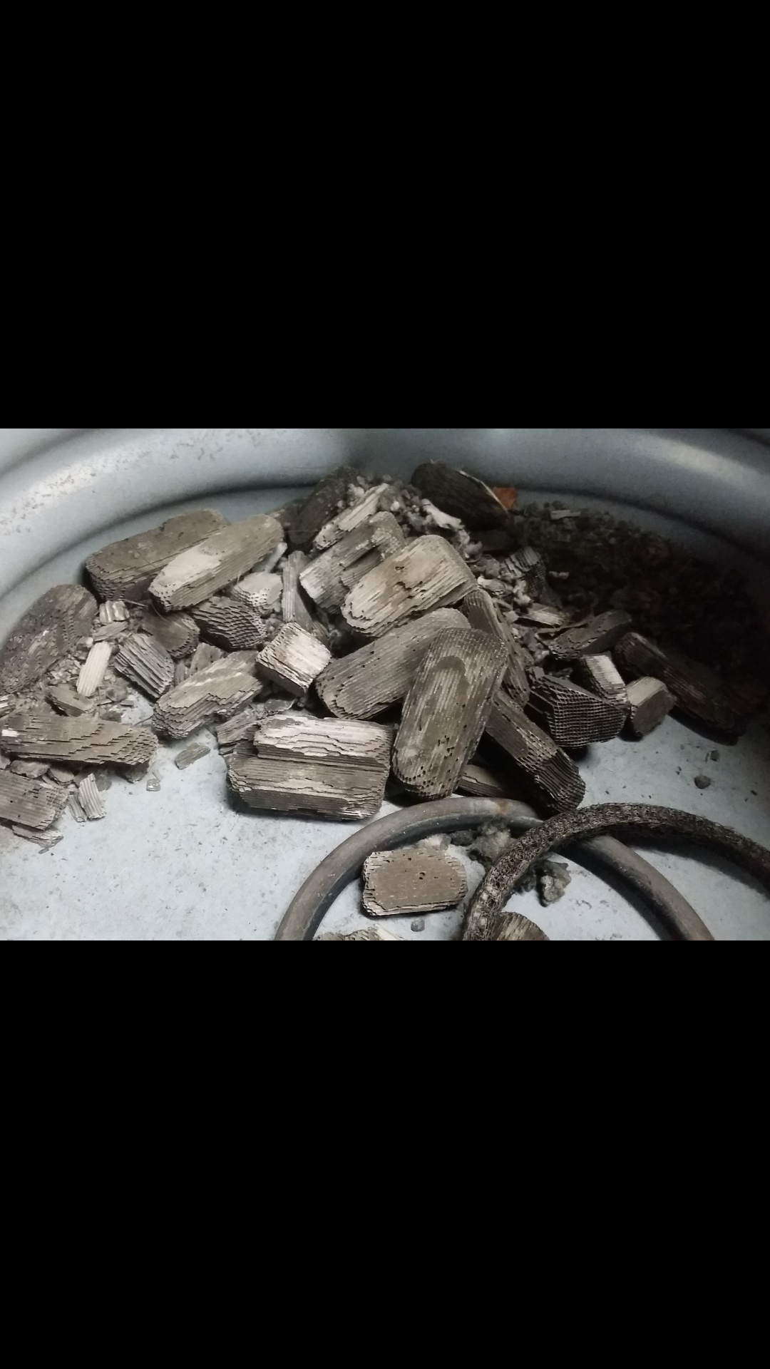

BAM Child uv KoRn all I can say is you the man! Your knowledge is greatly appreciated. Got ambitious tonight and tore off the front cat and pipe. Couldn't get the back cat off but what.... the front cat was was empty. WTF I thought ended up cutting the pipe in front of the last cat and wouldn't you know there is all my front cat guts. Looks like the main converter is plugged solid also. So my question now is if I delete the pre cats what is that going to do to the o2 sensors?
Attached Thumbnails Newb with a motor dilemma-screenshot_2016-04-25-20-40-20.png   Newb with a motor dilemma-screenshot_2016-04-25-20-40-30.png

This is exactly what happened to my first 3.5...except it killed the motor. You got lucky b/c the front bank was saved when it disintegrated completely and caused this big problem (the rear is tougher so it's just getting sucked up and eating the cylinders/rings). Many people on here disbelieved my report (and the precat failures in general), but this is pretty conclusive lol.
So, you've got it. Gut the rear and main cat and you should be good minus oil consumption.
The clog is definitely limiting the rpm, but it is suspect given how maf failure reacts, too. You'll find out after you fix everything. Grab some junkyard mafs (for freesies) if you need one.

.... So my question now is if I delete the pre cats what is that going to do to the o2 sensors?
Nothing, really.
You front/upstream O2 sensors will operate just fine. And they are the only ones that count.
Your rear/downstream sensors will complain that the pre-cats are not doing their job. Unless you live in CA or NY, you can ignore this complaint and install anti-foulers to get rid of the annoying CEL light.
Amazing pictures. Save them. And send a copy to Nissan and tell them what a lousy job they did on this car, and in this area in particular.
yeah that rattle noise def sounds like one of the pre-cat material was rattling around inside the housing. glad you found the problem, now you should be good to go. Just keep an eye on the oil levels.

So heres my hindsight now. I got the car with bank 1 & 2 cam sensor codes, 2 different cylinder misfire codes. Cam sensor codes were the vvt solenoids stuck. Misfire codes were 1 completely dead coil pack and 1 intermittent coil pack. My theory is the cat fell apart previously and the dead cylinder helped finally plug up the rear cat with the motor running poorly. Today I gutted the rear cat. I did it in place but wouldn't recommend it. Took a couple hours. I ordered a new rear cat for $110, welded in a new flex braid pipe and put in non foulers in the y pipe. If the car runs good I think I did pretty well. It was a fully loaded 1 owner car that was very well taken care of. I'll still have less than $1000 into it. This is for my daughter who just got her license.

Old Apr 26, 2016 | 09:16 PM
Child_uv_KoRn's Avatar
Bad *** Newb
Posts: 4,975
Nice job!
Just don't forget to check the oil every week
As you know, women will drive a car till it's D - E - D dead.
I did a clutch job for one where the throwout bearing was destroyed. There was nothing left inside. It was just a ground down shell in pieces! And of course, she had no idea what happened. It just quit starting one day
Had another with no oil in her truck. She was driving it around for days! Good ol nissan hard body.
