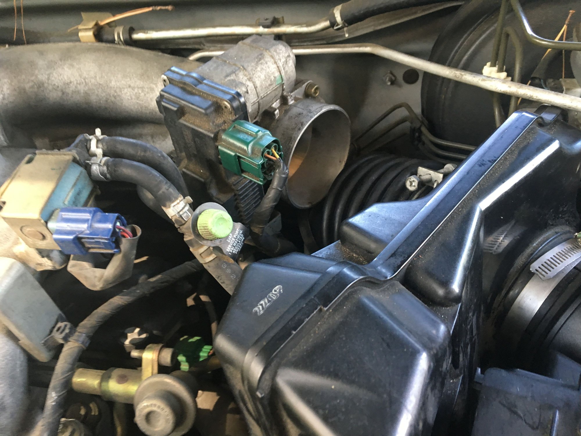

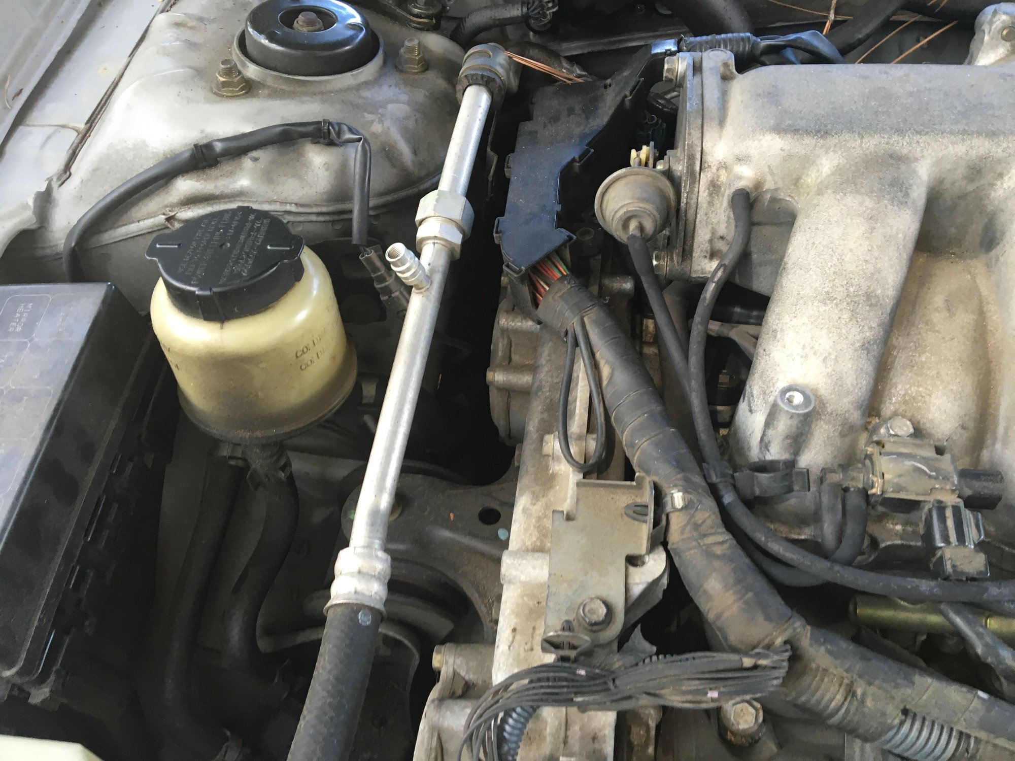

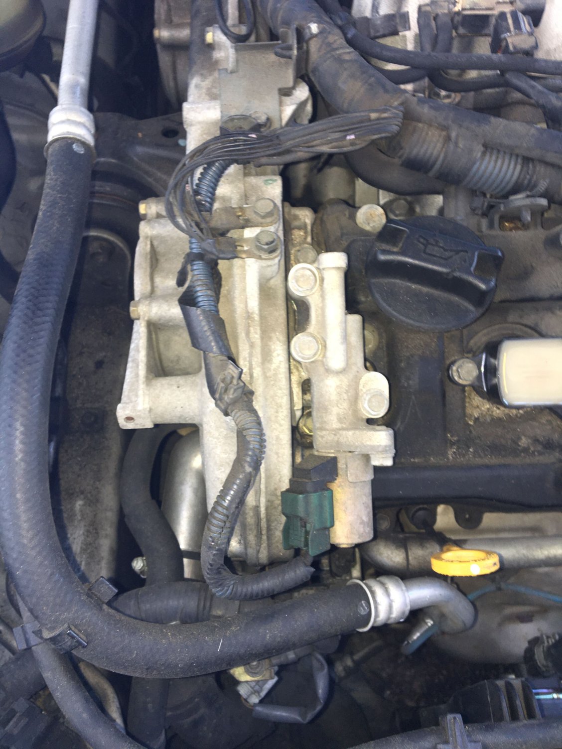

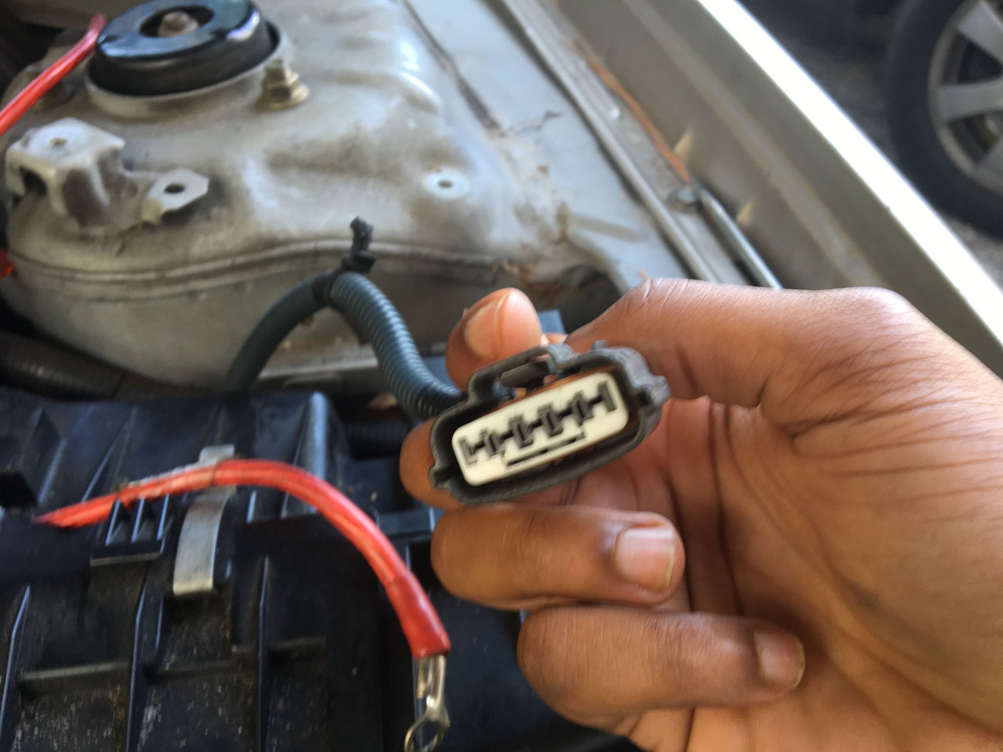

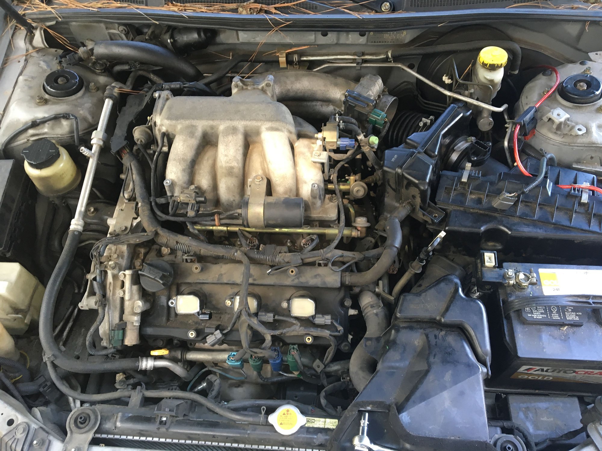

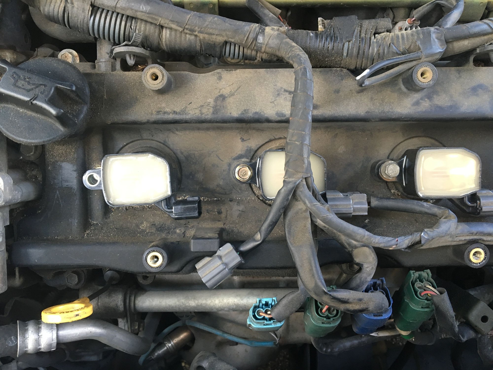

Snap a picture of the the coils on the motor, if possible snap a picture of the grounds on the timing chain cover. How old is your battery? I had a friend who had a Sentra that would not start for nothing but it could keep cranking. When we would jump start it it would run but like crap. A new battery solved the running and starting issue. Did you use ngk plugs aswell?

Old Aug 20, 2016 | 11:51 AM
ejenzo's Avatar
Joined: Mar 2015
Posts: 25
Old Aug 20, 2016 | 11:59 AM
MadMax SE's Avatar
Joined: Apr 2016
Posts: 276
Originally Posted by ejenzo
Those white topped coil packs look kinda weird to me, here take a peek at this thread maxima.org/forums/5th-generation-maxima-2000-2003/592156-price-best-place-buy-ignition-coils.html
What did you even pay for those coils? Most everyone in the thread say OEM is the way to go and aftermarkets just don't hold.

If you paid 40 for all of the coils, you definitely need to get an ohm meter to check their specs or reinstall the old coils if you have them.

Coils in the picture look highly skeptical. Especially at 40. Is that per coil or for all of them? Either way they don't look right. The pic with the boot off the throttle is that just showing the throttle plate? You're not trying to start car like that right?
Haha. I know better. I had just sprayed some throttle body cleaner again. But I can try and reinstall the old coils in the morning and give it a go. And it was 40$ for all 6. But reading all yalls comments I'm realizing cheaper was probably not better in this case.
Yea unless they're oem used coils $40 is very cheap and I suspect poor quality. Swap them out and do all the relearns just as it says in the 5.5 gen relearn thread.
