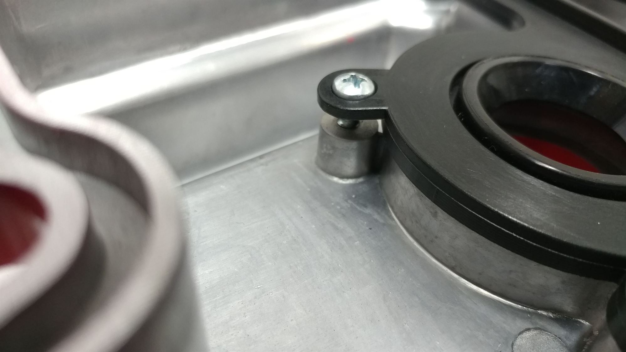

I ordered some of these covers and I decided to return them. Here is why.

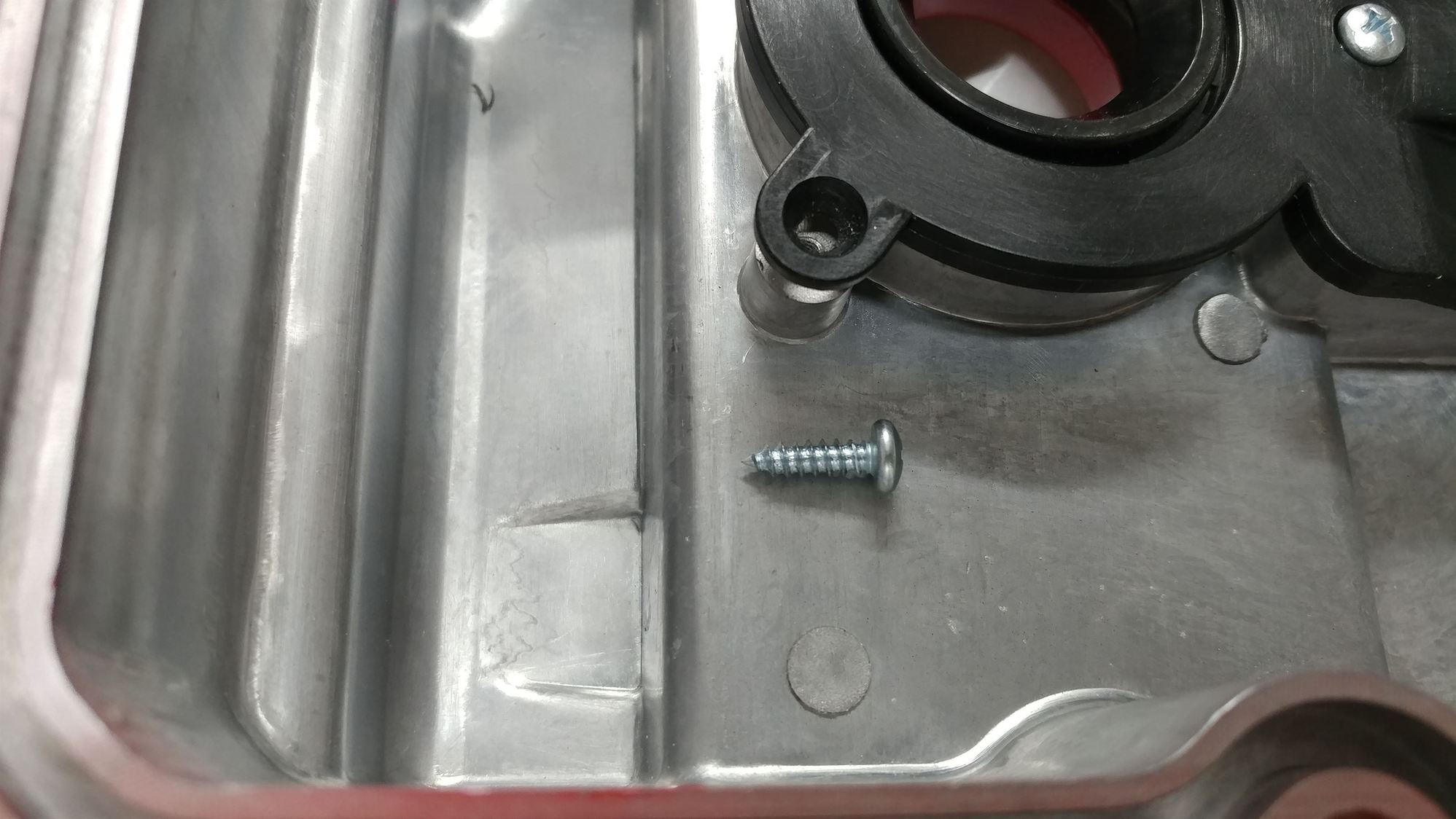

Quite a few of the screws that hold the spark plug seals in place were loose. Also, they are just cheap sheet metal screws, they aren't even machine screws. The holes are tapped for machine screws but they decided to use sheet metal screws for whatever reason. The thought of one or more of them coming out with all the heat and vibration of the engine made me a little too nervous to go ahead and install them. That would pretty much be game over.
I suppose I could have replaced all the screws with machine screws and threadlocked them but that's more than I want to do right now. It's really too bad because otherwise, they appear to be nice covers.

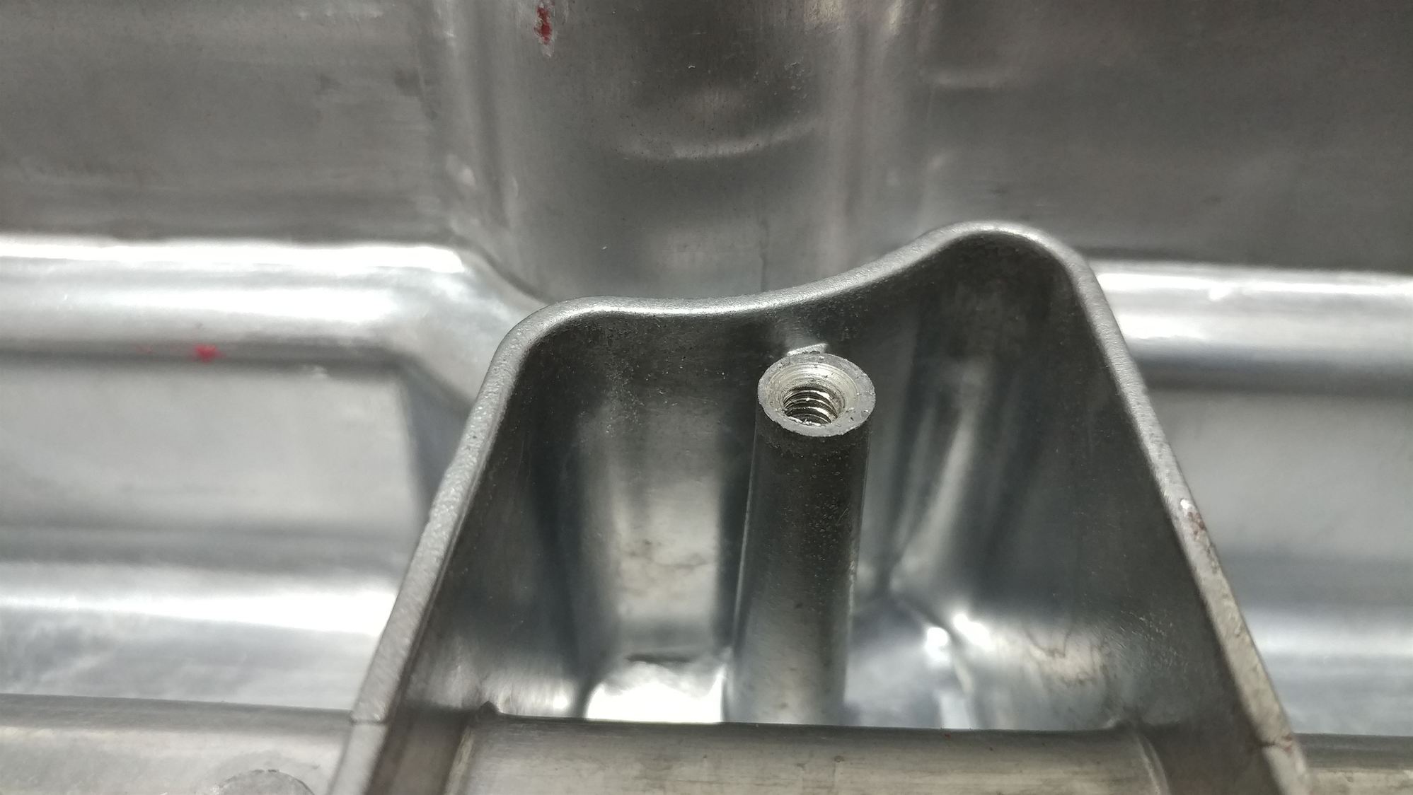

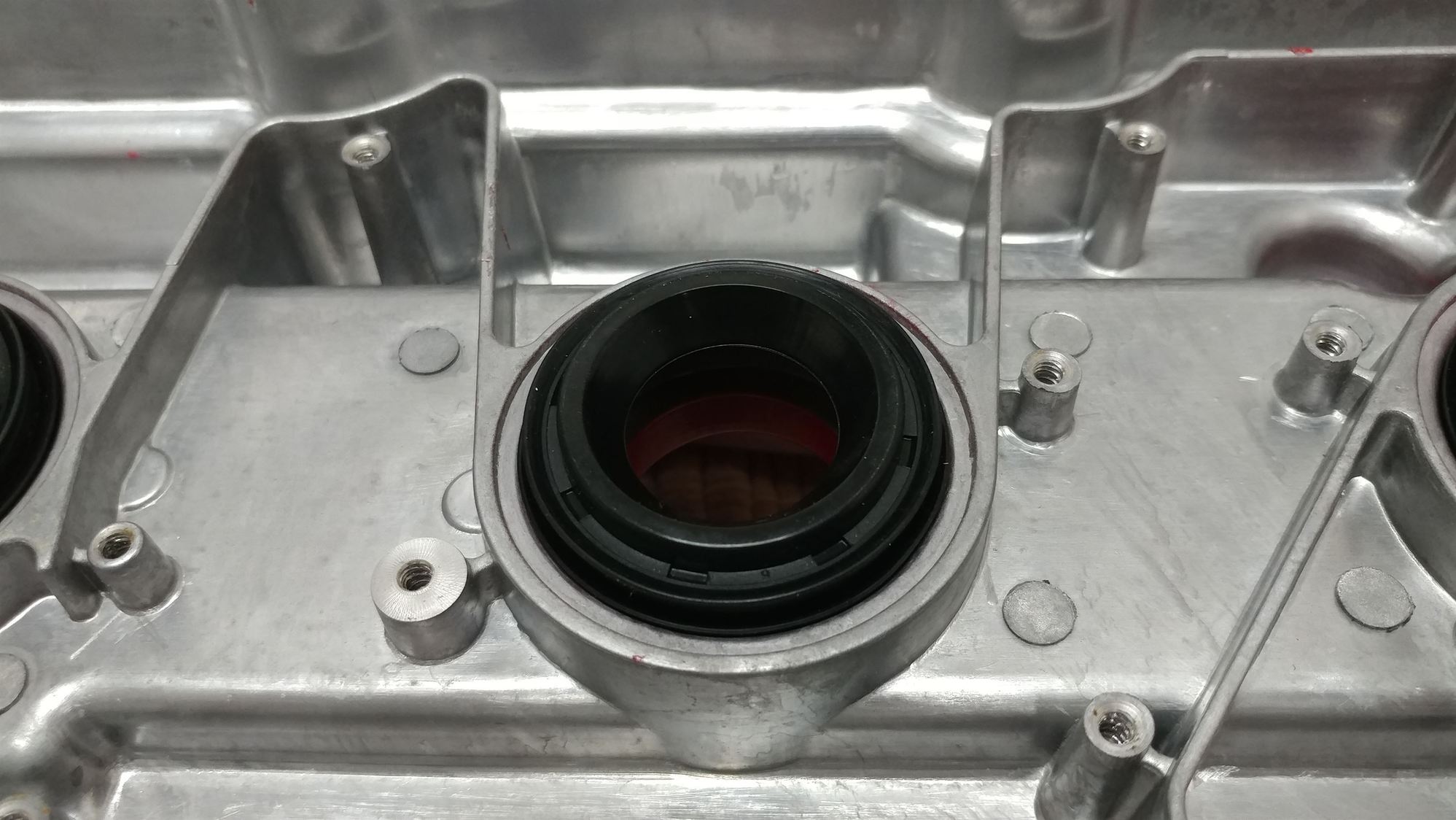

I completely disassembled the covers to see what was going on. Each of the screw holes is tapped with M4 x 0.7 threads, yet they drove in sheet metal screws instead of machine screws. Amazing. Also, the plastic covers for the spark plug tube seals are countersunk but the sheet metal screws have button heads. Brilliant. If you look on the listing for these covers, the picture of the underside shows exactly what I found, sheet metal screws, so I'm pretty sure this is a problem with all of these covers. On a positive note, the spark plug tube seals look pretty nice and they are independent of the surrounding plastic cover. If there is a source for these seals you could replace them if they started to leak. When I brought this to the attention of the seller it was clear they aren't interested in correcting any of these issues.
In order to use these with any confidence, I would want to chase all of the threads with an M4 X 0.7 tap, get correct flat head screws and use some sort of thread locker.
Threaded hole

Spark plug seal
Spark plug seal removed
Countersunk hole
You can't really tighten this screw without bending or breaking this tab
