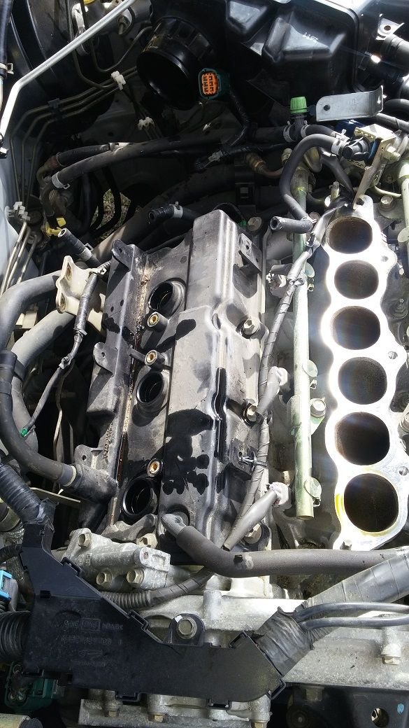

Pulled the coil on cylinder ??#6?? (rear right) and it was drenched in oil. Replaced rear valve cover assembly. Moved that coil to cylinder #1 just in case it fails, it's easier to get to.
Noticed light oil residue on the intake gasket. It looks like the PCV feeds oil into the lower section of the intake and it has lightly discolored the lower bank of the intake runners. Those runners lead to the front cylinder bank, so the front bank has been slowly fed oil for most of its life.
From the small dealer I got it from, the oil was absurdly overfilled. Like just over a full quart. Fairly clean, but I'm changing it very soon regardless because of the next statement.
Seafoamed it. Actually it was Chemtool B12. Through the intake line right behind the throttle body. 1/4 bottle or so. After getting it back to temp and doing a few WOT pulls, I ran about 2 cups of hot water very slowly through the same vacuum line. This made no difference in the mild rough idle I talk about next. (This is why I'm going to change the oil soon. Carbon breakdown and some possible blowby of water into crankcase.)
Before I get into the other questions, the car has a minor stumble at idle. drives 100% fine, but at a stop, I can feel the car shuddering ever so slightly. I am going to replace the coils since one of them was soaked in oil due to bad tube seals, but it's just not as buttery-smooth as the VQ30. At idle and in gear, if it wasn't for the exhaust, I'd barely be able to tell it was running. If the above-mentioned oil-soaked coil is mildly intermittent, is there a risk of that cat being damaged back there?

Thanks for the insight so far. Here are pics of the intake and the oil discoloration of the lower plenum channels. When I shot throttle body cleaner through it, it came out pretty brown.
See pics for notes
This picture is actually to show the oil residue you can see on the intake gasket to the right. I was taking a picture of the oil I slung oil all over the valve cover from that back spark plug tube being full to the brim with oil.
Very clean internals.
Note the darkened plenum passages where the PCV feeds oil into the lower part of the manifold and front runners. Intake cleaner took it right off, but it came out rather dark and thick.
Intake runner leading to rear bank. I didn't think to take a pic of the front bank that should be of more concern since that's where all the oil is being delivered.
